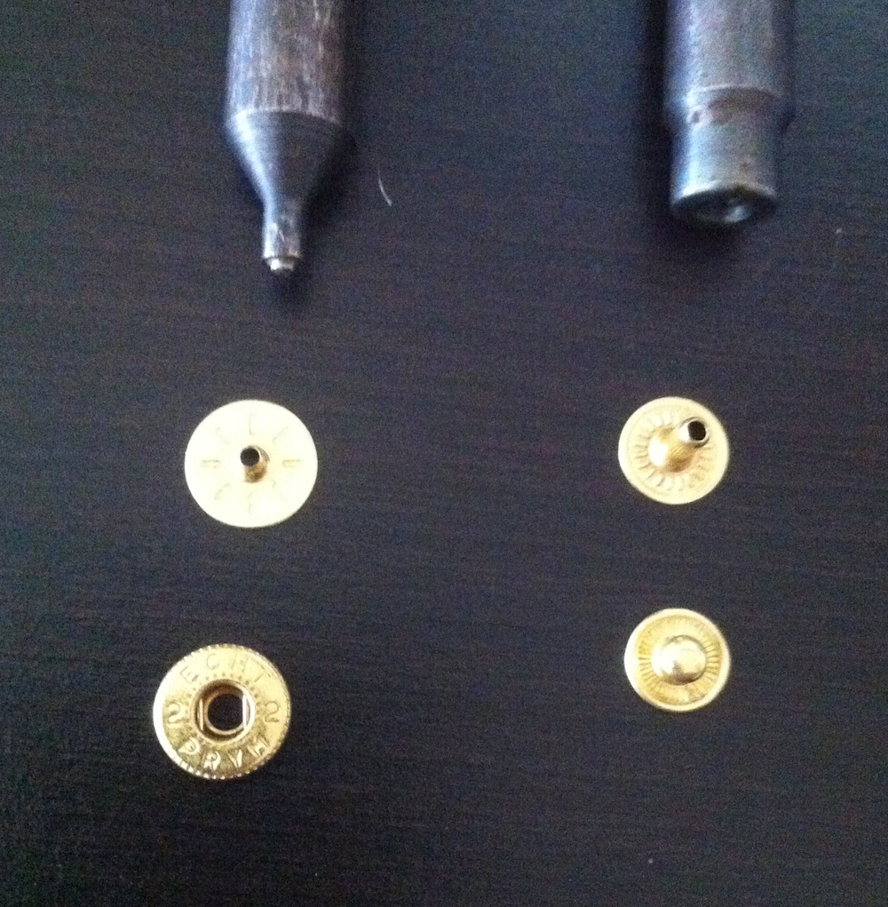

Members thefanninator Posted April 12, 2014 Members Report Posted April 12, 2014 I'm using small Prym snaps and the appropriate setters (shown in the pic). The snap on the left won't set very good. I bought these from Ohio Travel Bag. I have a hand press that I'd like to use but as far I know there are no dies for Prym snaps. If you also use Prym snaps what are you doing to set them? How are your results? Where do you buy your snaps? Quote http://www.instagram.com/fannintexas/
Members Andrew Chee Posted April 12, 2014 Members Report Posted April 12, 2014 With great difficulty. I tried using the Prym snaps and they just don't set easily. I tried the setting tools they sell for them and they don't really work. I ended up buying SW snaps from universal fasteners (now owned by YKK) and they work much better. You have to have a resellers license to purchase from them. The snaps themselves are not expensive but the setters are. I am about to place an order from them if you want to purchase anything. PM me. Andrew Quote
