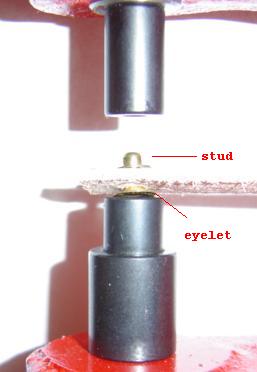

I have a Tandy hand press with a set of dies for Segma snaps but no instructions.
I think I have the cap dies on the right figured out but I'm not certain about the male side which I think is the set on the left.
The male end might sit in the hole on one die and I'm not sure if the stud side fits on or inside the other die?
post-19342-0-20994700-1397588207_thumb.j
Thanks.
Kevin.

I called the store and the manager pulled a set of dies from the store and we discussed the issue, I said I thought I had it figured out but didn't want to take the chance of breaking anything and he said if I did he would come good for it. RIGHT ON!
This may help the next victim
post-19342-0-12988600-1397594221_thumb.j
post-19342-0-31717600-1397594228_thumb.j
post-19342-0-77504900-1397594237_thumb.j
