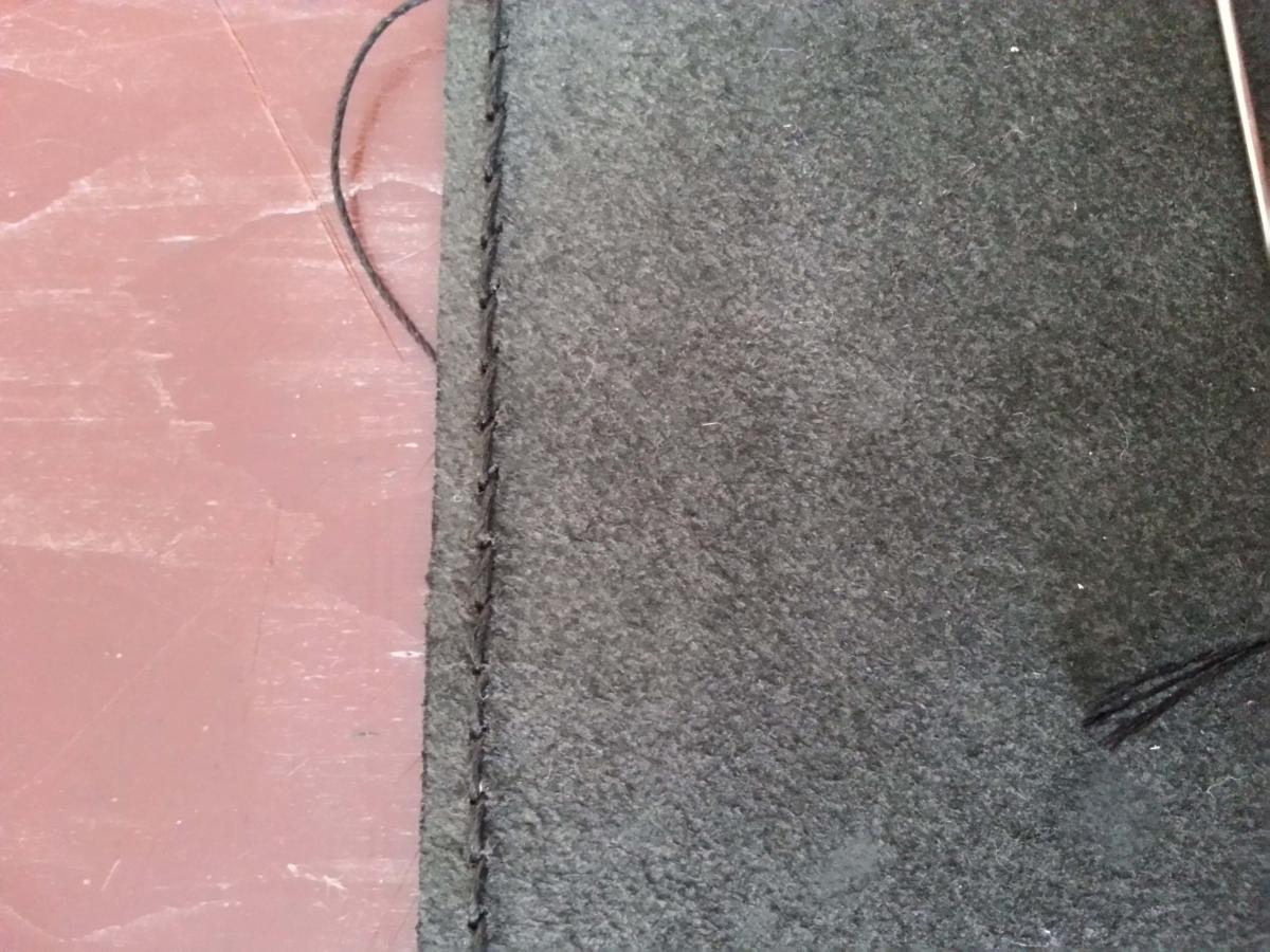

Members mrtreat32 Posted April 24, 2014 Author Members Report Posted April 24, 2014 I would say you are using some pretty thick thread for that stitch count. I am right this minute stitching something 7spi using 277 thread. I will try to post a pic in little bit. It is nice and clean looking. I would think 432 would be kind of bulky looking for 7spi. I don't know what you are sewing, however I think you might get a less bulky look with that thread if you went down to 5spi. I definitely dont want to do more stitches per inch. In fact I want to try out 9spi pretty soon. Im just starting out but Im interested in making smaller items. Maybe the thread is too big. Im a bit confused on how sizing works since it seems like different manufacturers label them differently? http://www.fineleatherworking.com/linen-thread/waxed-linen-black Here is a picture that shows you the thread Im using and what the size looks like for reference. It says they are using it on 9spi and it looks ok. I ordered 2 small spools of tiger thread that I have not yet tried. one .008 and .006. The Fil au chinois 432 that I mentioned looks very similar in thickness to the .006 tiger thread. A lot of folks from what I read seem to like the 1mm tiger thread..seems like that would be big unless they are stitching large items with 5spi or less? thank you. I have a ton to learn Quote
