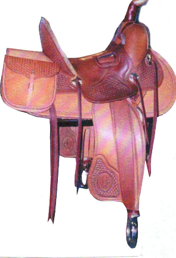

Timbo Posted January 24, 2008 Author Report Posted January 24, 2008 Well, actually no, it turns out I don't have someone to walk me thru...........but then again, I've got access to some of the best right here in this forum!! I got an PM from Don earlier and he sent me some excellent links to go thru. Can't wait to read them. The above pic is pretty close to what I want to build the first time out. I might go with a half seat though. Then again the loop seat is pretty sweet too. Not sure yet. Thanks for all the advice. Tim Quote
