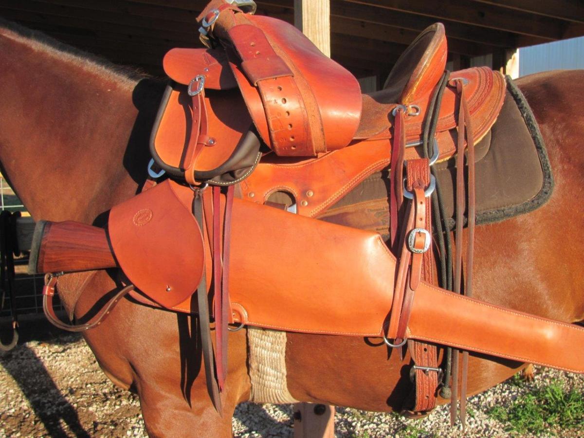

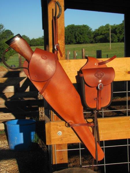

I've made several this fall like the one pictured below. Get a long piece of butcher paper or some other similar heavy paper that you can have long and wide enough, I use velum paper in a 24" wide roll used for printing construction plans.
Get your piece of paper that is as long as your rifle or so and fold it in half and proceed just as you would for the Stohlman holster pattern making process. Lay the scope on the center of the fold and "roll" it over to the side, trace around the rifle and scope, I leave at least 1" and maybe a little more to the edge of the pattern around the barrel and then a little more than that once you get to the fore end of the rifle. Make a nice curve down to where you wand it to end on the stock and draw a flap that looks nice to your eye.
Good luck,
Josh
post-19070-0-66284900-1415628384_thumb.j
post-19070-0-67333400-1415628402_thumb.j
Josh, thanks for the great photos! That's given me some good ideas about what I want to do.
