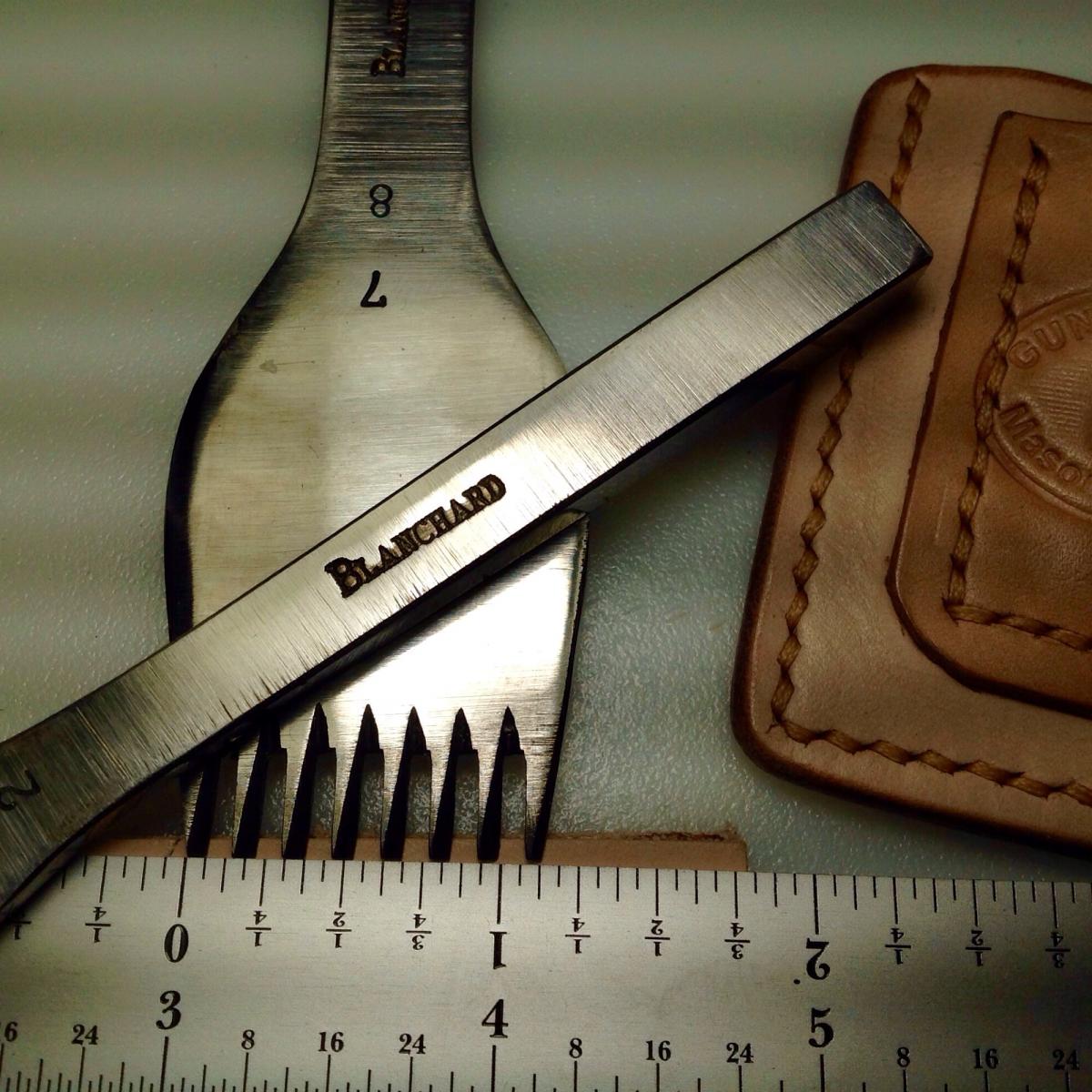

Oldtoolsniper Report post Posted December 9, 2014 Here is a picture of the irons I own. Blanchard 7 8 and 7 2 7 indicates 7 stitches per inch 8 tells you the number of teeth on the iron. Again 7 indicates stitches per inch and 2 is the number of teeth on the iron. As you can see on the ruler 7 is the number of holes or pricks produced in an inch. I'm not sure how other folks measure an inch but I'm betting if it says 7 stitch per inch then most reputable tool makers will shoot for that when they make or sell a tool. As close as I can get it the tip measures at 1.8mm or about 0.071" but they obviously get wider as they go deeper into the leather. Quote Share this post Link to post Share on other sites

Macca Report post Posted December 10, 2014 Maybe it's just a bad angle on the picture, but that looks as though you would get 6 and a little bit SPI with that iron, not 7. I'd have returned that, guess this is the issue David has seen with his. For comparison , I just checked a few Dixons irons and they are absolutely spot on Quote Share this post Link to post Share on other sites
Hi Im Joe Report post Posted December 10, 2014 Maybe it's just a bad angle on the picture, but that looks as though you would get 6 and a little bit SPI with that iron, not 7. I'd have returned that, guess this is the issue David has seen with his. For comparison , I just checked a few Dixons irons and they are absolutely spot on I think he needs to center the slits on the line instead of lining it up at the outside edge. That would help a bit but you are right that seems pretty off. Quote Share this post Link to post Share on other sites

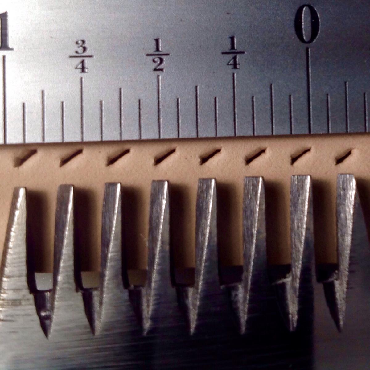

Oldtoolsniper Report post Posted December 10, 2014 (edited) Here it is from a better angle. Edited December 10, 2014 by Oldtoolsniper Quote Share this post Link to post Share on other sites
DavidL Report post Posted December 10, 2014 I believe vergez measures using Teeth per inch the same way saw's are measured. Unless they recently changed it to Stitches per inch, or they could be defects like you said. Quote Share this post Link to post Share on other sites
Oldtoolsniper Report post Posted December 10, 2014 I must be lost. I count seven holes from the zero line to the 1 inch line on the ruler. That would give me seven holes to fill with thread in one inch. That says there are seven teeth to the inch or seven stitches to the inch. What am I missing or not understanding? I am new to this and I'll admit it is a little confusing to me. The fact that most if not all pricking irons come from countries who use the metric system of measurement, but then they have teeth per inch or stitch per inch measurements. If you ask how big the teeth are most everyone gives that as a metric measurement. This is also how I see the gaps between the teeth are measured. DavidL I'm an avid woodworker with hand tools, I sharpen all of my handsaws by hand with a file. I'm not sure how they are counted different. A five point per inch rip saw has five points per inch, the saw is stamped 5 or listed as 5PPI. Quote Share this post Link to post Share on other sites
Hi Im Joe Report post Posted December 10, 2014 I must be lost. I count seven holes from the zero line to the 1 inch line on the ruler. That would give me seven holes to fill with thread in one inch. That says there are seven teeth to the inch or seven stitches to the inch. What am I missing or not understanding? I am new to this and I'll admit it is a little confusing to me. The fact that most if not all pricking irons come from countries who use the metric system of measurement, but then they have teeth per inch or stitch per inch measurements. If you ask how big the teeth are most everyone gives that as a metric measurement. This is also how I see the gaps between the teeth are measured. DavidL I'm an avid woodworker with hand tools, I sharpen all of my handsaws by hand with a file. I'm not sure how they are counted different. A five point per inch rip saw has five points per inch, the saw is stamped 5 or listed as 5PPI. It takes two holes to make a stitch. So if you have 7 holes in a one inch span you got six stitches. Quote Share this post Link to post Share on other sites
