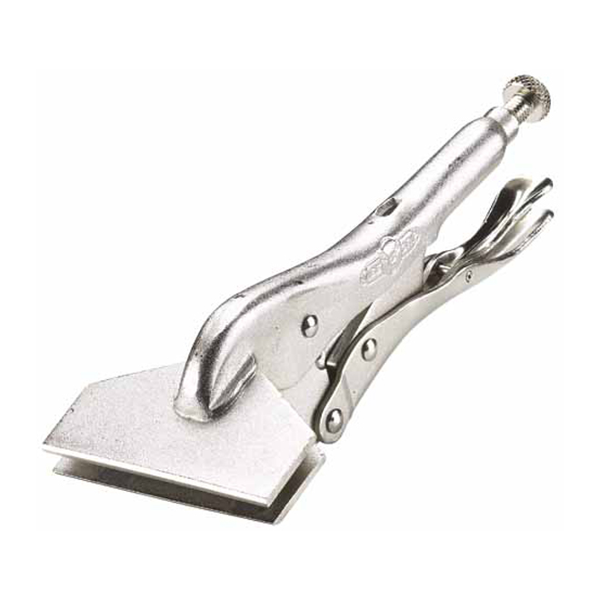

Members silverwingit Posted November 3, 2015 Members Report Posted November 3, 2015 For pulling wider strips, try one of these sheet metal vice grips. They grip uniformly, making for fewer twists, turns and bulges in the splits. http://www.rona.ca/images/0244009_L.jpgMichelle Quote
Members J Hayes Posted November 3, 2015 Members Report Posted November 3, 2015 Yeah, had one of those in my hands at a yard sale, still not sure why I put it back. I was very surprised I was able to pull that and have it come out as nice as it did, that blade scares me a bit.... Quote
