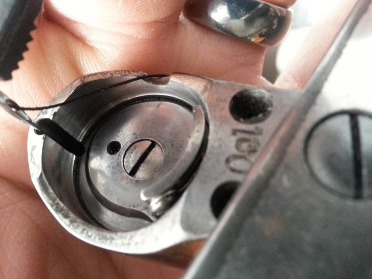

Members drunknpirate Posted December 8, 2014 Author Members Report Posted December 8, 2014 The gear that you have a 56 on in the photo is different then mine. Mine has teeth all the way around. regardless, the machine looks like its movments are correct, just out of time.Wiz, I dont have a hole on the front. There is a threaded stud with a nut coming out the front and a hole in the back of the machine http://im1.shutterfly.com/media/47a4cc26b3127ccef79a5f41b19f00000030O00AatGTZy0ct2IPbz4C/cC/f%3D0/ls%3D00107949624520141208004730143.JPG/ps%3D50/r%3D0/rx%3D550/ry%3D400/ http://im1.shutterfly.com/media/47a4cc26b3127ccef79b111c91a900000030O00AatGTZy0ct2IPbz4C/cC/f%3D0/ls%3D00107949624520141208004732047.JPG/ps%3D50/r%3D0/rx%3D550/ry%3D400/ Any idea of what this machine is worth? If I over paid I still have time to return it. Its the head only, no stand. Has a chip in flywheel, thats about the only defect, well besides the timing Quote
