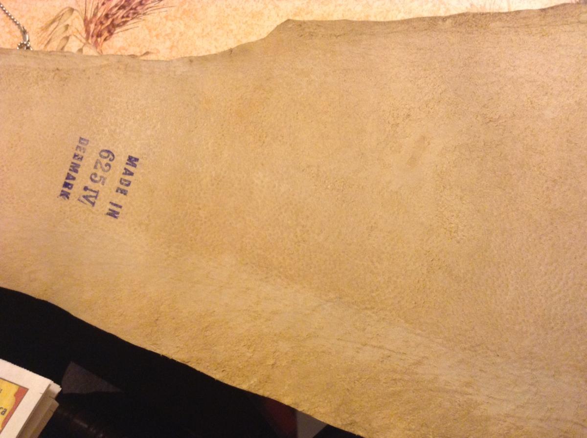

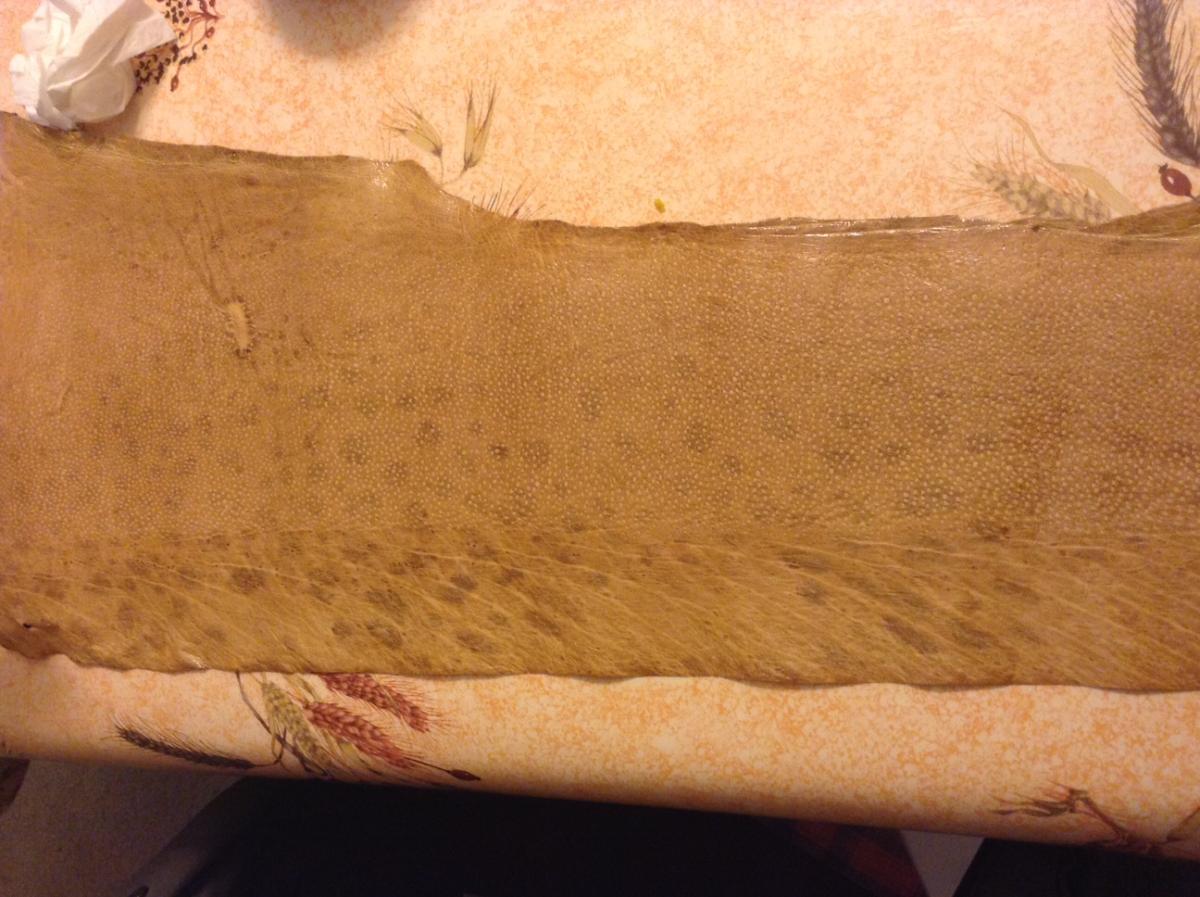

Members Avgvstvs Posted December 25, 2014 Members Report Posted December 25, 2014 Hi, My father just found this skin in his stuff. He doesn't remember where he got it from. Any idea from what animal this skin might have come from? It is about 10 inches wide at the widest point, 4 inches at its narrowest. About 42 inches long. Also, with this skin there were 2 snakeskins. My dad says the skins might be over 25 years old... What should I use to condition those? And the mystery skin? Thanks! Quote
Members Greystone Posted December 26, 2014 Members Report Posted December 26, 2014 eel ?? Quote www.facebook.com/pages/Greystone-Leather www.etsy.com/shop/GREYSTONELEATHER
Members Avgvstvs Posted December 26, 2014 Author Members Report Posted December 26, 2014 (edited) It could be some sort of eel (a huge one) but it doesn't look like anything that shows up in google with keyword 'eel'... Edited December 26, 2014 by Avgvstvs Quote

Members Tiara Posted December 27, 2014 Members Report Posted December 27, 2014 looks a bit like wolffish http://www.atlanticleather.is/index.php/en/wolffish-leather generally the eel leather I've seen for sale is in panels and isn't actually eel but hagfish and is fairly smooth with a line of wrinkly skin down the center. Oh the snake skins, which I love to work with, I've had good results with most of the usual products. Depends on how brittle they are. I have one old but still useable good sized piece of karung that is a bit brittle as well as some lower grade thin lizard skins that were rather brittle. I found some good info here on preserving old leather http://nautarch.tamu.edu/CRL/conservationmanual/File7.htm the glycerine/alcohol has helped on those with restoring flexibility but will leave it somewhat sticky and prone to pulling moisture from the air in humid conditions resulting in some translucence and made it a bit harder to glue later on. I have also used pecards exotic leather dressing on reptile leather but found that worked best for me applied after all work is done more as a surface finish--does add depth to it. What I've liked best so far with these brittle skins prior to working with them has been http://www.amazon.com/Lexol-NF-Neatsfoot-Leather-Dressing/dp/B006CUZ2UU working small amounts into the skins with fingertips to both sides and letting sit at least overnight before adding another coat, has not darkened too much and that will lighten up again after a week or so to close to the original shade, not given me any trouble I can recall with gluing and gave the best results with being able to work softer once I have enough on and it wicks all the way through. I tried pure neatsfoot oil once on a snakeskin I dyed that became very stiff after drying. Foolishly put on way too much and it made it so dark and oily I wasn't at all what I had hoped for. However, some alcohol helped get off a good part of that but it took time for that skin to lighten back up enough to be useable. Like 2 years of sitting in my scraps. I found that gently stretching in all directions and rolling it some with my hands, that lightened the color some more by bringing air into the scale pockets. After all this time, that piece finally was put to use as a nice cuff Quote
Members Avgvstvs Posted December 27, 2014 Author Members Report Posted December 27, 2014 Looks like you nailed it Tiara! It sure looks like Wolffish! Thanks for the link on leather conservation, there seems to be a lot of useful information on that page. I'll have to try that Lexol product! Thanks! Quote
Members Tiara Posted December 27, 2014 Members Report Posted December 27, 2014 I've had a hankering for wolffish leather since the first time I saw it. Hoping down the line to see about getting the minimum order needed to make the shipping worth it. That and some of the cod skins looked very interesting. The company is willing to ship undyed skins in smaller amounts than dye lots. Prices not bad, it's the shipping that makes it pricier than I can justify right now. However let us know how that skin works out. It might interest some folks to consider chipping in and buying a larger amount, splitting the costs and skins. Quote
Members simontuntelder Posted December 27, 2014 Members Report Posted December 27, 2014 It's wolffish. Or Havkat as we call it in Denmark. It's quite funny seeing something that's actually made in Denmark. But during the Second World War a lot of fish was used - especially for the upper leathers on shoes - because there was a scarcity of materials during those years. I talked with a leather monger here in Denmark, and it turns out that his family originally made their money and built the company on fish skins that they tanned. Nowadays wolffish mainly comes from Iceland. Quote
