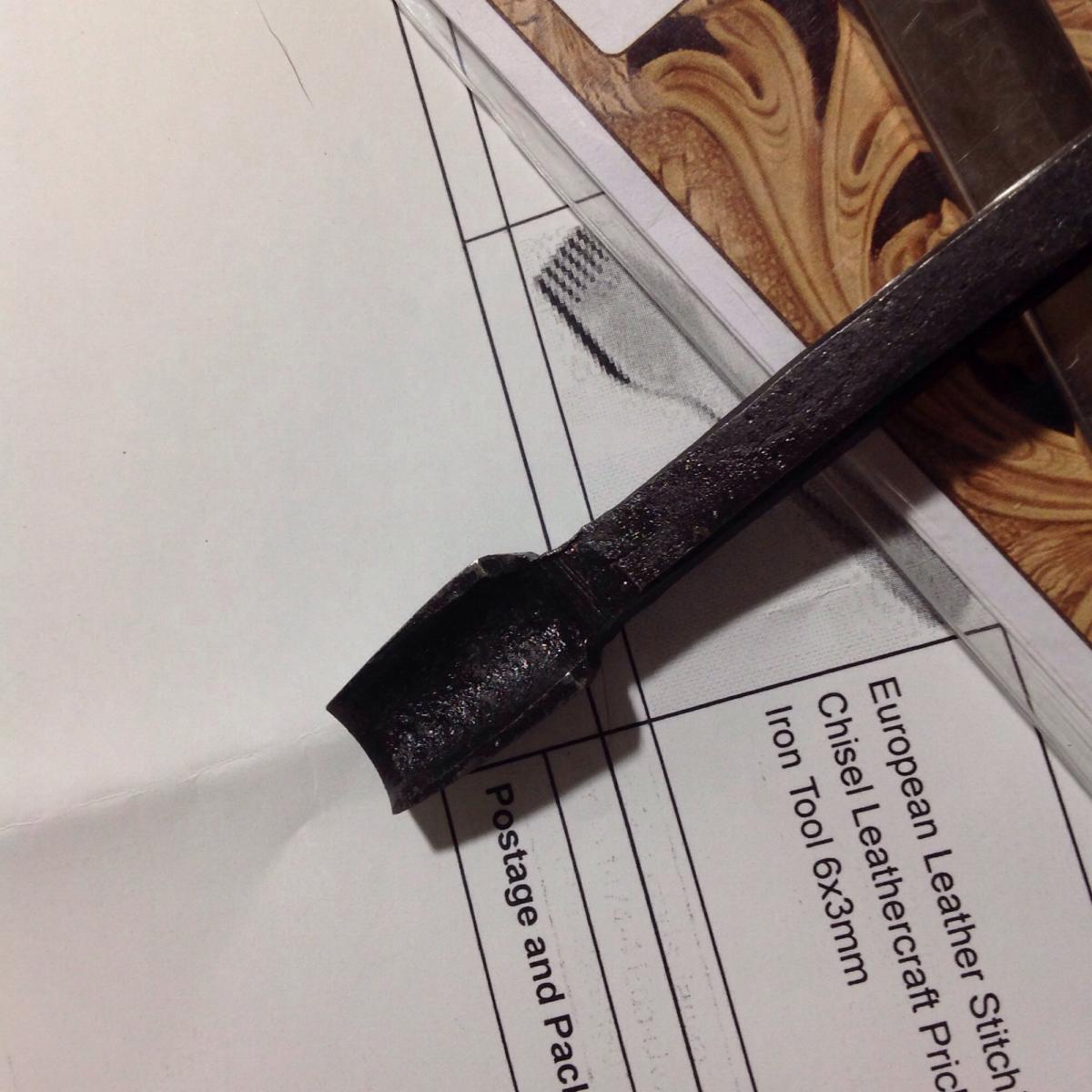

Members YinTx Posted February 24, 2015 Members Report Posted February 24, 2015 Found this on the 'net. makes one wonder. I didn't know Blanchards had that rough a finish on them. But I've never owned a set, maybe someone that has some can comment. http://translate.googleusercontent.com/translate_c?depth=1&hl=en&prev=search&rurl=translate.google.com&sl=ja&u=http://www.leathercraft.cn//%3Fproduct-17686.html&usg=ALkJrhiul0hgBymZLW0YJCwKamSKsz2C-g YinTx Quote YinTx https://www.instagram.com/lanasia_2017/ https://www.youtube.com/playlist?list=PLK6HvLWuZTzjt3MbR0Yhcj_WIQIvchezo
Matt T Posted February 24, 2015 Report Posted February 24, 2015 Yes, the Blanchards are not a polished finish. The picture of the rusted irons is the result of neglecting to take care of the tools. Quote Leathercraft supplies
Members Oldtoolsniper Posted February 24, 2015 Members Report Posted February 24, 2015 (edited) The Blanchards will rust if not taken care of, most any cutting instrument will suffer the same fate if not taken care of.. Some collectors call it "Patina" and it sells for more money that way, to me it's just rust. Here are my Blanchards as shipped to me. I keep them waxed because they will rust. The edge that does the cutting is sharp and they don't stick in the leather but then I don't drive them through the leather either. As for the rest of the tool being polished to a mirror finish it is not. I'm not sure what the purpose other than how the tool looks polishing the entire thing would serve. It would bring the cost up and they are already costly enough. The cost will keep most folks diligent about taking care of them.. Edited February 24, 2015 by Oldtoolsniper Quote
Members YinTx Posted March 18, 2015 Members Report Posted March 18, 2015 I guess the main part I was wondering about was the fact that the pricking irons in the photos from my post are made in China, and appear to be an exact replica of the Blanchards, minus the branding mark. I think they are claiming theirs will not rust as the Blanchards do. Thought perhaps this was the source/manufacturer for the Kyoshin Elle irons, as I got to this (Chinese) web page by following links on GoodsJapan's web site. YinTx Quote YinTx https://www.instagram.com/lanasia_2017/ https://www.youtube.com/playlist?list=PLK6HvLWuZTzjt3MbR0Yhcj_WIQIvchezo
Members vicroll91 Posted March 18, 2015 Members Report Posted March 18, 2015 I'm going to venture a guess and say that the KE pricking irons are not actually polished but rather, chromed. The finish is much too uniform for me to believe it was polished on a wheel. Not to mention a full polish on the tool is pointless. I prefer the raw steel of a dixon to aid my grip of the tool. Quote
