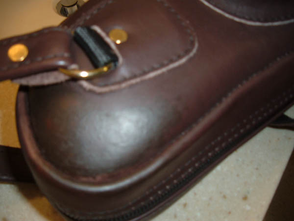

Its really hard to make a recommendation without actually seeing the damage. Is it possible to post some pictures and we'll take it from there.
Yes I have some but they are not very good. I also have a Photoshop image to show what it might look like after a monotone dye job. I did a virtual dye job! LOL!
The first 3 PIX show the damage near the edge of the case and the last two PIX are Photoshop renditions of what a dye fix might look like.

Awesome virtual dye job.
That body looks like chrome tanned leather so this is going to be fun. The good part is there isn't much texture to the leather
This is what I would suggest. Hit that area with deglazer. I wouldn't do the whole thing, but take that finish off for about 2 inches around the stain.
Once your deglazer has dried, Now clean it. I would recommend using some dawn and a tooth brush. Rinse using a spray bottle, you want to try not to re-deposit the stain. Repeat a couple times. let it dry. See if it lightened it up at all. It should have lightened it up some. Now comes the fun part. Use a piece of 1200 grit sand paper and hit the stain.
Now airbrush or shoot the color on. Obviously start light and work it up. I would recommend using diluted acrylics.
Now finish it.
Good luck

Sounds like you are wanting to try to match the color and feather it in or do you think I should nuke it black??
If I do the whole case shouldn't I deglaze all of it?? BTW The guy called about 30 minutes ago while I was on a conference call. He will be calling back in about a half hour! LOL! He is persistent.

Yeah if you want to match it, then yes I am trying to tell you that. If the customer doesn't care, nuke it, just make sure you have him sign something saying it is ok.
There really is no need to deglaze the whole thing. Every jacket, case, and car seat I have ever repaired, I only concerned myself with about 2 inches around the trouble area. With proper prep, and finishing, there is no need do remove the whole finish. It also helps reduce the amount of other things that can possibly go wrong.
If you are going to nuke the case, then you will have to deglaze all of it.
