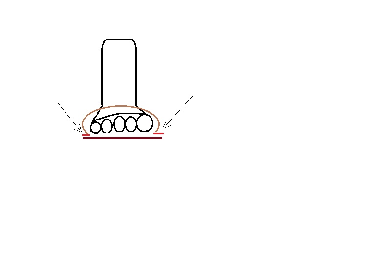

I live near a privileged town, Delaware, Ohio, . . . still has a full time cobbler, . . . open 6 days a week, . . . does excellent work.
I asked him the same question (want to make a pair of Western boots some day, . . . on my bucket list y'know), . . . and he said you sew a strip of leather to the bottom of the pieces of the shoes, . . . AFTER the basic form has been molded on a form called a "last".
The strip is the red color in the drawing, . . . his example was about 2/3 oz, . . . and about 3/4 inch wide. He said to sew that in the position as in the drawing, . . . all the way around the shoe, . . . then take a sewing machine, . . . sew that strip to the sole, . . . putting the shoe together.
Hope this helps.
