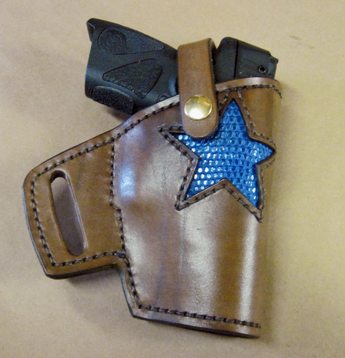

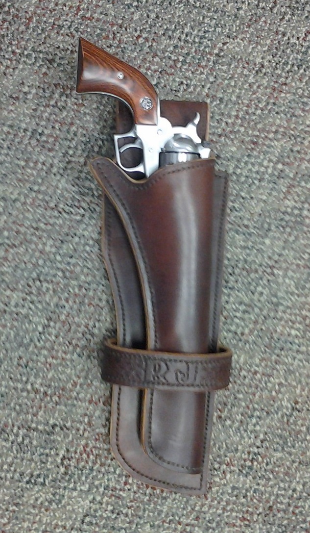

The big one is two layers of 7/8 oz Hermann Oak laminated together, the Ruger .44 Mag has a 10-1/2" barrel. I don't think he was wanting it for concealed carry. The two Taurus 9mm are two separate pistols, the one with the wide holster has a laser sight attached below the barrel, other than that they are the same. The star inlay is Sea Snake (dyed blue).

Tom,
I don't remember the model, they were 9MM. I wouldn't have a problem sharing the patterns, but I don't keep them, I make a new one for each holster and throw them away when the job ships. Sorry,
Chief
Thats okay, Chief. The one I need to make is a 9mm as well. I'll just make up a pattern. I was concerned about the laser sight on the pistol. Did your pistol fit loose? Is that why you put on the retention strap?
Tom
Tom
I've done a few of these with the laser sight and by their design they have to fit a little loose, if not there is a danger of turning the sight on when holstering the weapon and you can sew in under the trigger housing because the area is filled. I always recommend a retention strap regardless, this customer asked for them before I suggested them.
