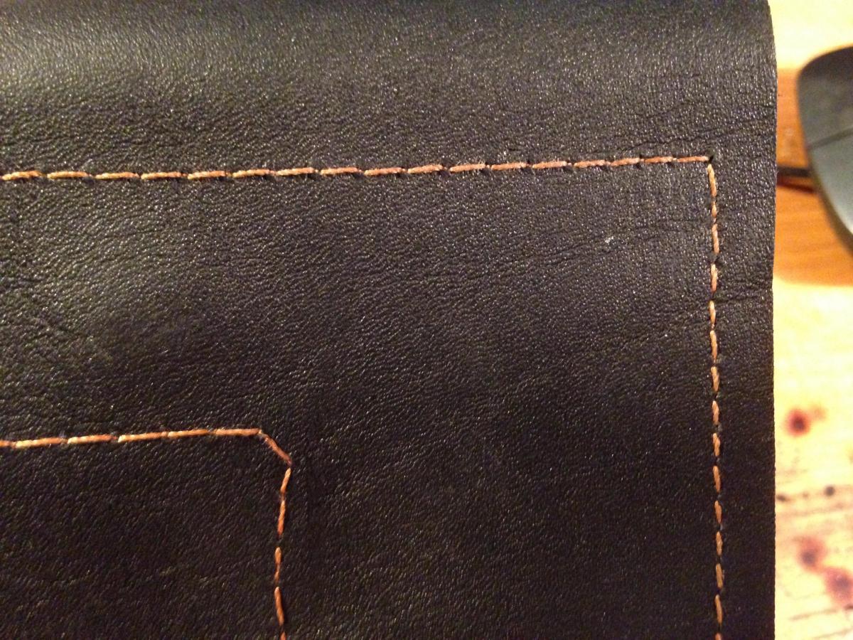

Members TinkerTailor Posted March 22, 2015 Members Report Posted March 22, 2015 (edited) On most of the treadle machines ive come accross, the presser foot pressure is controlled by an adjuster directly above it on top of the machine. It is usually a cap or bolt that pushes down on the presser foot spring. Btw, I have, on junky machines, experimented with adding washers, stretching the spring to add pressure, and other mods however this can and will wear stuff out faster and break things. Proceed at your own peril here.Here are some pics of a underseat bicycle toolroll i a currently working on. All the stitching is done on a white rotary FR machine on treadle (with liberal handwheeling). It is 1 layer 3-4 oz of Hot stuffed bridle and 1-2 layers of 4-6oz hot wax stuffed boot leather. Both chrome tan, the bridle is veg re-tan and is very stiff. The boot leather is pretty supple. Total thickness stitched is 7mm, looks like 6 here due to angle: My starrett micrometer says 0.237" which works out to about 15 oz total thickness. Backside of stitching: Frontside: Frontside 2: (there is an extra stitch hole at the corner....my machine runs so smooth, it sometimes drops the needle slowly into the work if i am not looking. Sometimes i wish it was still a little gummed up) Edited March 22, 2015 by TinkerTailor Quote "If nobody shares what they know, we will eventually all know nothing." "There is no adventure in letting fear and common sense be your guide"
