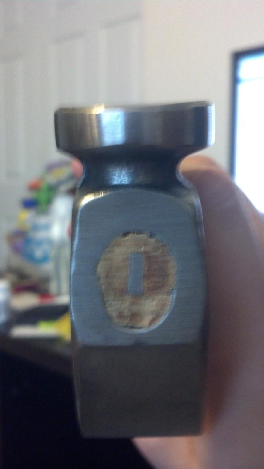

So I've started gathering tools to get started on leatherworking as a hobby. In the course of doing this, I recently purchased a used Osborne #66 on eBay, the head of which appears to be extremely warped and misshapen to me. The "claw" and mounting portions of the head are not perpendicular to the handle and and almost appears to have been twisted. The striking surface is not remotely symmetrical. Looking at it from the top down, the right-hand side of the striking surface sticks out further to the side than the left and curves forward, while the rest of the surface is mostly flat. Also, the metal between the striking surface and the rest of the head is pinched in quite a bit more on the right than on the left. This thing more or less looks like it's been in a car accident.
Am I just so much of a newbie that I don't realize that this how leatherworking hammers are supposed to look, or is my gut right and I just got sold a lemon?

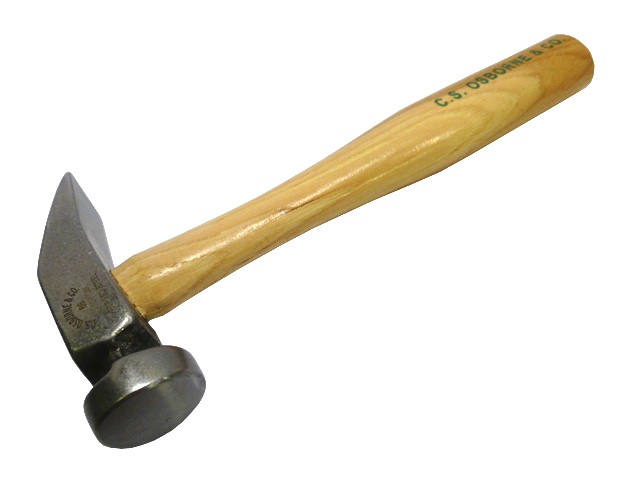

You don't say what kind of leather work you are doing. For the most part you want a Poly or leather mallet or maul. If your hammer does not look like the one in this link then you probably have one that has been abused. http://www.frankfordleather.com/tools/osborne-66-shoe-hammer.asp You did not post a picture of your hammer. Judging from your description it might take a little more then refacing on a grinder to have a usable hammer. You should not use metal to hammer most of your stamping setting tools etc. You will tend to mushroom the ends. So unless
you are going to be driving a lot of tacks or use the hammer for smoothing (does not sound like it will work for that in it's condition) I would set it aside and get a good poly or rawhide mallet or maul.

Thanks for the input guys. The picture that camano posted is of the one I have. You can see the words "C.S. Osborne 66" written on handle if you look closely enough. Osborne advertises it as a leatherworking hammer, and actually has a separate hammer advertised as a "shoe hammer" (the 65), but from what I've seen, given the style of it's head, it's generally accepted as a cobbler's hammer.

I got it for the purpose DavidL mentioned, flattening seams & shaping leather, as well as for closing seams when gluing pieces together. That's why the shape of the striking face is a problem. The main thing I want to do is make small, thin minimalist wallets, so the warped portion would end up striking the table and causing the rest of the hammer to hit at an angle, which would defeat the purpose of using it, and it's almost useless for shaping, since the warped portion would have a substantial chance of digging into the leather and leaving gouges. I'll be getting a poly mallet for hammering punches, chisels, etc... as well.

I tried to get a pic of the front of a hammer. There is about a 2 degree or so radius on the striking surface. Your hammer should not have a flat face. As a comparison, ball peen hammers are almost the same on the face of the flat side. You do have the correct style for pounding flat seams/folds in leather, just yours is mis-shaped.
post-2349-0-60570400-1427079147_thumb.jp
I looked at the pictures again and now i think it has been ground to clean it up. I think the seller cleaned (read: totally destroyed) up the face on a bench grinder and the concave would be the radius of the wheel. Because it was a bench grinder, the handle probably got in the way of turning it 360 to get a good face shape. Also, If you look at where the handle comes out the top, there are wear and work and use marks in the wood that have been recently ground away. Some bozo Effed it up with crappy grinding. Shoulda just wire wheeled it, or left it alone.
You could just re grind it to a very slight dome fairly quickly with carefull use of a bench grinder or with a sanding disc on an angle grinder, and the hammer in a vise. This method would allow you to get a better dome without taking out the handle.I like the discs because they are easier to control, easier to swap for higher grits, cheap, and dont leave divets as easy as stones...Plus a piece of sticky back sandpaper won't explode unexpectedly and shoot chunks of rock at mach 7.6 towards your eyes balls.
