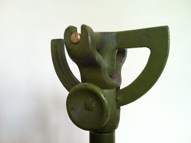

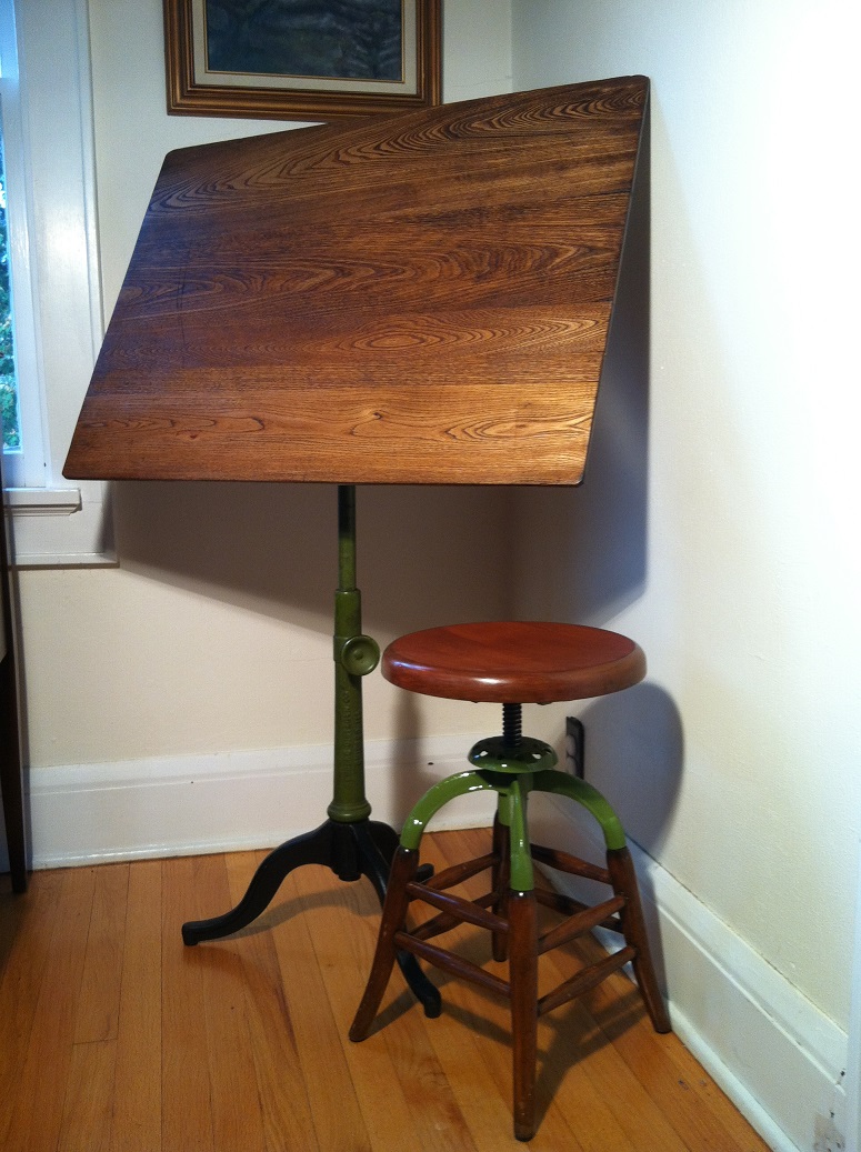

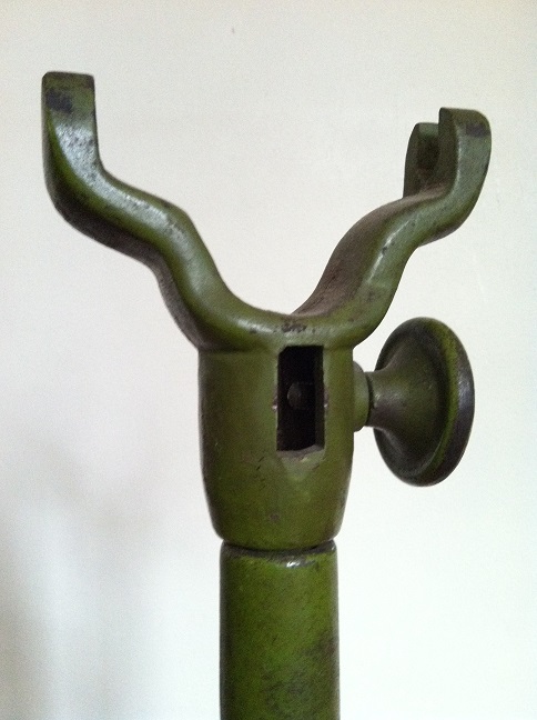

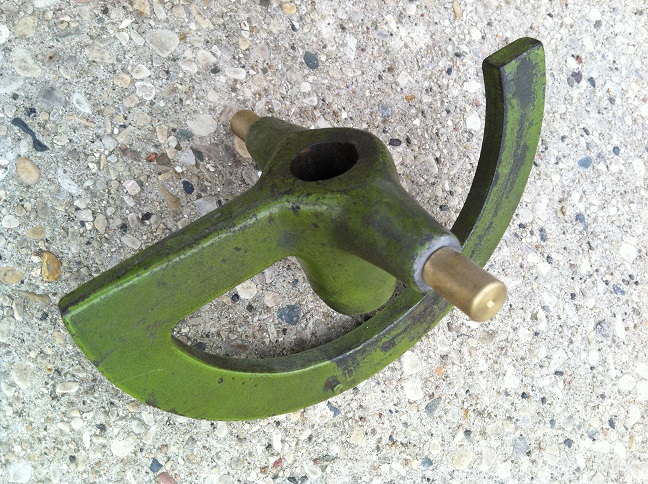

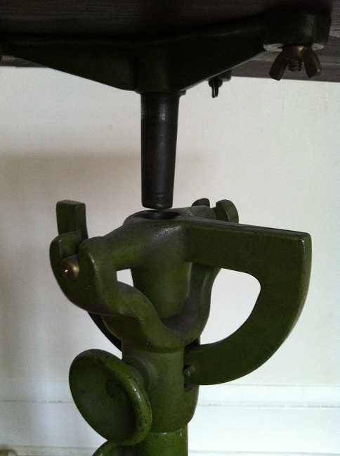

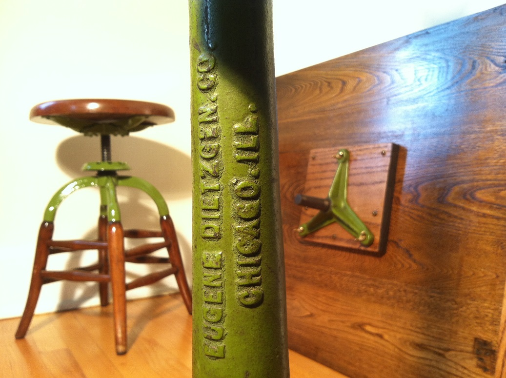

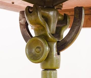

Members chriscraft Posted March 26, 2015 Author Members Report Posted March 26, 2015 (edited) I've seen plenty of stands built out of truck steel rims and drum brakes like BBQ pits, bird feeders and mail box post. I would like this build to look more factory built. Would like it to look like it was intended for leatherworking. Like it belongs in a leather work shop and blends with all the other well built leatherworking equipment. Maybe I am asking for too much from myself but I think I can pull this off. I am not trying to re-invent the wheel here but borrow what already exist. For example, I have this early 1900's Multum Drawing Table that was purpose built. It is smaller than your average drafting table from this era. It was built and designed by a well known manufacture of drafting equipment based out of Chicago. The base can be adjusted in height and the table top can rotate, tilt or be used in a flat horizontal position. This same wooden top was made to be removed and swapped out with another wooden top if you were working on multiple projects. I really like the simplicity of this design but it has to be beefed up to be able to take a beating like an anvil. This drawing table base is made from cast iron and is over 100 years old. I have no intention to try and use this for my purpose. The function and idea is what I will borrow. I wish this Multum Drawing Table was 100% original. I put it together from photos, all I had was the original cast base and rotating table neck/head. The wooden top and drawing chair are not original. After painting this chair to match, I arranged them together to make this look complete. Howard, I don't think I will need an arm rest. Maybe I just got used to working without touching my artwork. When I would rest my arm I would somehow damage my work as the paint would not be dry or smear stuff all over my project. One of the reasons I want this to rotate is to keep from touching my project over and over again. Chris Edited March 26, 2015 by chriscraft Quote
Members chriscraft Posted March 26, 2015 Author Members Report Posted March 26, 2015 (edited) Took more photos of the drawing table stand. I really like the appearance of this old cast iron stand. The tooling platform does not have to tilt so the drawing table tilting head doesn't have to be copied. I know were not doing blacksmith iron work here so it doesn't need to be built like an anvil. I'm thinking if it were constructed from heavy wall steel, 1" thick steel plate, this might be what it needs to lower the pitch of the tooling sound a bit. My previous photo that shows the adjustable screw height stool was my first thought of making this stand. Edited March 26, 2015 by chriscraft Quote
