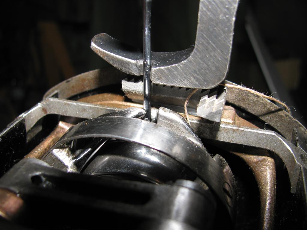

Oh - I forgot to mention that the needle bar has two timing mark (I hope yours has them). The upper mark should be barely visible in the lowest position of the needle bar and the lower mark should be barely visible when the hook tip meets the needle scarf. But some additional fine tuning may be necessary.
  • Picture 1 shows the lower timing mark in the lowest position of the need bar - upper mark is barely visible (you cant see it on the picture).
  • Picture 2 shows the lower timing mark when the hook meets the needle scarf.
Thats the timing my machine works fine with. Hope this helps.

post-31854-0-45004000-1427280350_thumb.j
post-31854-0-04058200-1427280356_thumb.j
