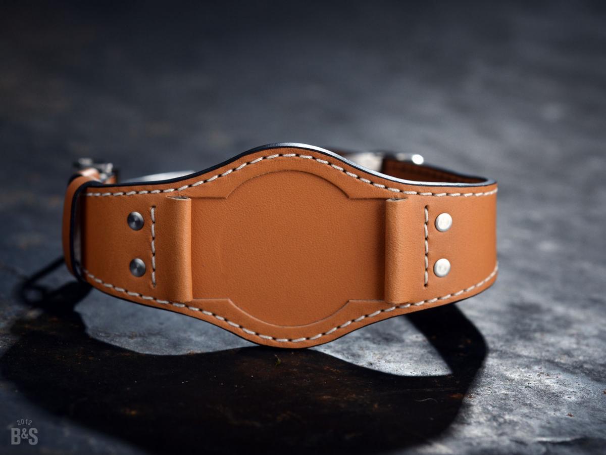

Members Tugadude Posted April 18, 2015 Members Report Posted April 18, 2015 Mark, this is a bund style strap I made up based upon one I saw in a Tudor watch ad. I reverse engineered it, making some modifications along the way. The straps holding the watch fold back and under and don't show from underneath. Quote
Mark Peters Posted April 18, 2015 Author Report Posted April 18, 2015 So the straps holding watch are cut from the main strap and tucked under? Quote
Members Tugadude Posted April 18, 2015 Members Report Posted April 18, 2015 Yes, sort of an "H" shaped cut. I thinned the flaps down and when tucked they don't bulge much. Quote
