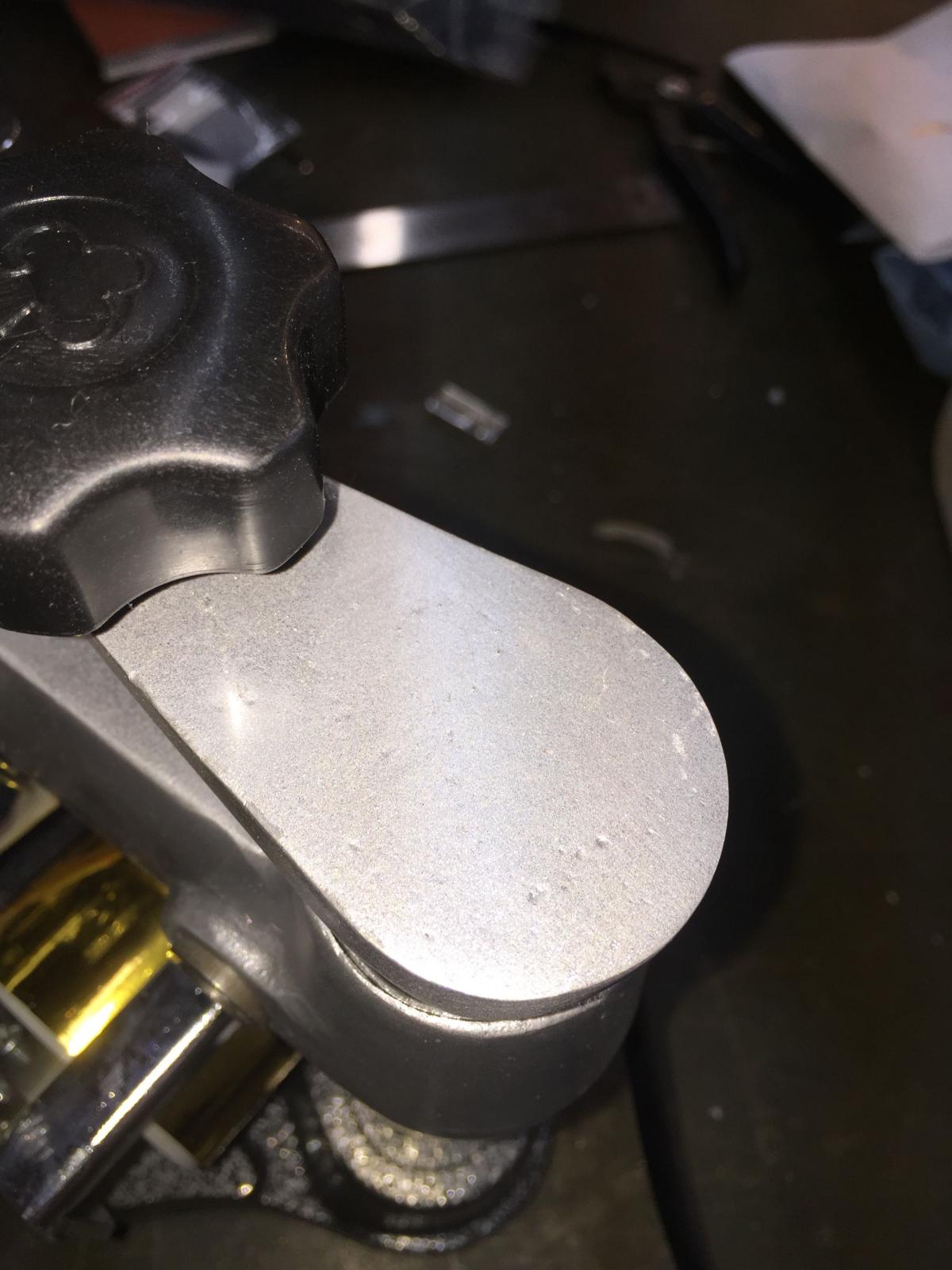

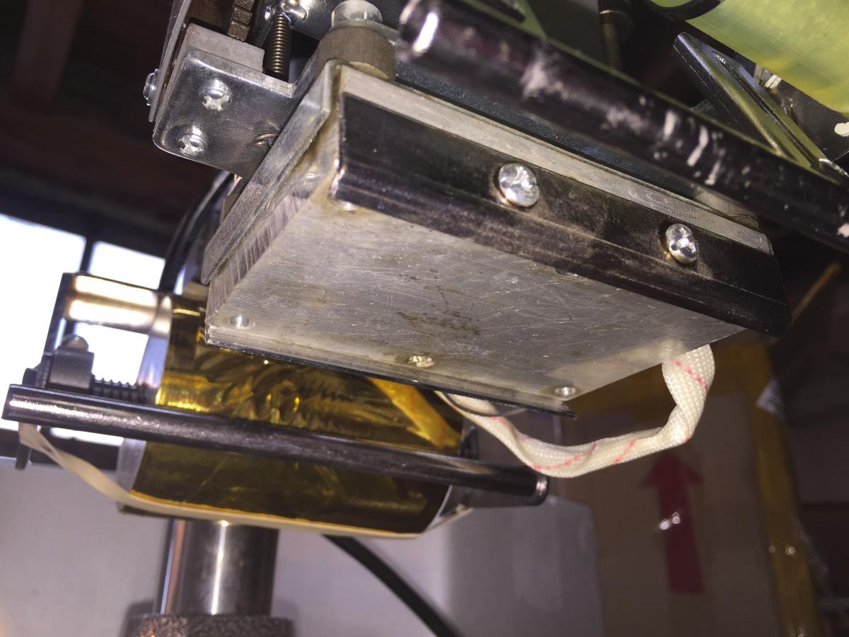

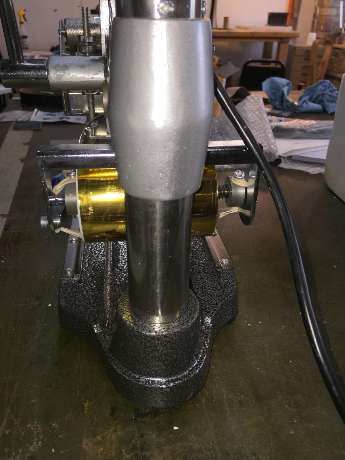

Pics of this garbage machine before I sent it back.
Wiring loom and heating element started burning and oozing discolored grease on first use.
post-45824-0-03775500-1433969159_thumb.j
Castings are crummy and the general fit and finish is poor.
post-45824-0-74582200-1433969192_thumb.j
post-45824-0-39699700-1433969201_thumb.j
post-45824-0-99764100-1433969275_thumb.j
Poor quality welds that were rusty out of the box.
Working parts poorly aligned (!!)

Heating surfaces looked used upon first inspection.
