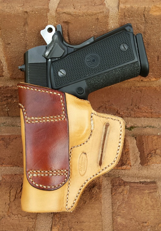

Ok, so here goes... first attempt at an "Avenger" style holster.
I don't think I've got my patterning down just right yet... The reinforcement/belt loop piece keeps wanting to occupy the same real estate as the stitching that follows the form of the pistol. This wouldn't be a problem except for the reinforcement/belt loop piece obviously has to be sewn on before the holster is stitched together... and it's a real headache trying to guestimate where the belt loop should be so it's not in the way when I go to do the final stitching (suggestions??)
Any suggestions, thoughts, criticisms, experience, suggestions, or suggestions (did I mention suggestions?) you can offer would be greatly appreciated.

How are you laying out the pattern? If you're tracing the gun, then just keep your "belt loop piece" inside the lines of the gun. The stitch line would of course (unavoidably) be outside of that.
OH - - and I'd round that corner a bit (above your rear slot, under the grip) so it's not quite so sharp. But realistically, I don't think you're doing as badly as you seem to think ...

Maybe I should have clarified...
My first pattern used a narrower "belt loop piece". I always layout my patterns on cardstock, and the "belt loop piece" didn't overlap the stitch lines... all was well. However once I wet molded, the "belt loop piece" magically shifted. When I say that, I mean it seems crooked. I'm assuming it's got something to do with the way the leather stretches? I'll post a picture of what I'm talking about. The first pictures I uploaded weren't actually the "first" shot at this style...
Anyway, the reason the "belt loop piece" overlapped the stitch lines on the 2nd attempt was because I was trying to make up for the "magic shifting" that takes place during wet molding.
Clear as mud?

That looks better. Not sure why you felt the need to pull that back (toward the bottom of the weapon). I like as much "bearing surface" as I can get, but in the end you can only keep just so much. And the only part that "counts" is the part that rides the belt.
Beyond that, I would angle your stitch lines at the "belt loop piece". Angle it roughly the way you want the weapon to ride. It not only lays better in there, but also allows you a bit more "bearing surface" on the belt without widening the loop.
You like the second uploaded pic better? I thought the first much better... lol to each his own. Not sure what you mean about "to pull that back (toward the bottom of the weapon)"... could you elaborate?
I like the idea about angling the stitching... definitely going to incorporate that into the revised design!
I thought we were talking about the belt loop -- or what I sometimes call the reinforcement (and sometimes "thingy"). In that case, the last pic is "better".

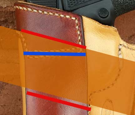

post-13153-0-09001200-1434163237_thumb.j
If the belt is brown, then putting the stitch lines in (red) at the same angle is double benefit.
It "locks" teh belt much more securely -- keeping the holster from "rocking" on the belt. Sucks to go to pull the gun, and have the holster move ...
Plus, those math guys will tell you that angling the lines (especially the top one) allows more surface contact between the holster and the belt. LIke, say your holster is angled at 20° forward. Then the blue line is your original stitch line. Say that's 1.25" wide. Then the red, angled stitch line (which rides the belt) will be about 1.33" long (something about a cosine of 20° angles -- you'd have to ask a math person). Basically, that 20° line will be 6.5% longer than your "straight" measurment, without widening the piece. Doesn't sound like much... but a 1.25" strip would "grow" the line by nearly 3/32", or in other words, the safely the amount you're going to edge and burnish (in english - what was the starting size would now be the FINISHED size).
