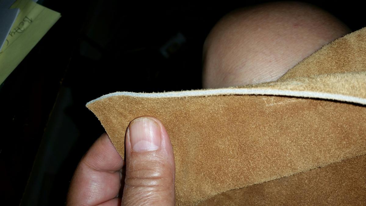

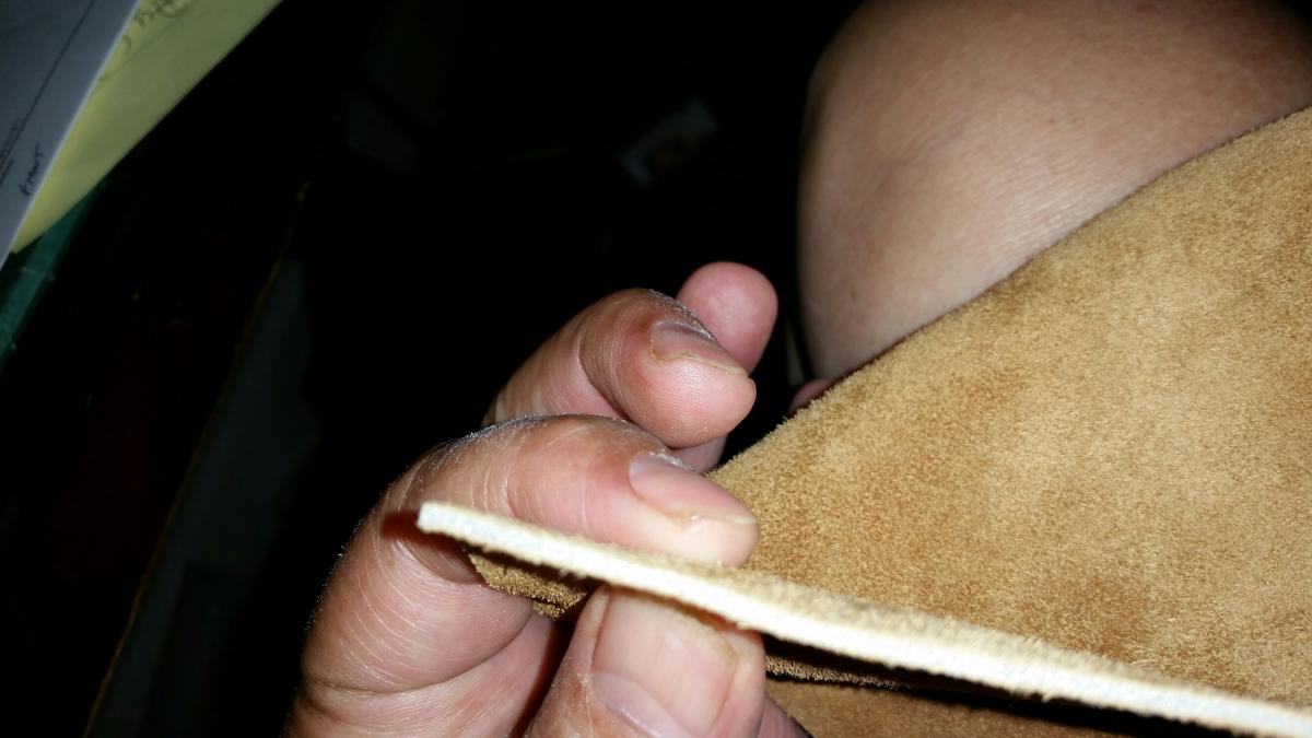

Members OLDNSLOW Posted June 20, 2015 Author Members Report Posted June 20, 2015 this is what it looked like after a few minutes in boiling water, along with what it looks like. Quote
Members OLDNSLOW Posted June 20, 2015 Author Members Report Posted June 20, 2015 well the larger size leather curled up and got stiffer than the dickens, so is that to mean that is veg tanned. thanks O n S Quote

Members simontuntelder Posted June 20, 2015 Members Report Posted June 20, 2015 What you have there is cow split that has been chrome tanned. If it's thick and pliable that almost always a give-away, but in this case what does give it away is the white center line in the cut. If it's blue/green/yellow/very white then it's a chrome tan. And of course the fact that veg tan contracts with temperatures over 70* celcius (or there about) Quote
