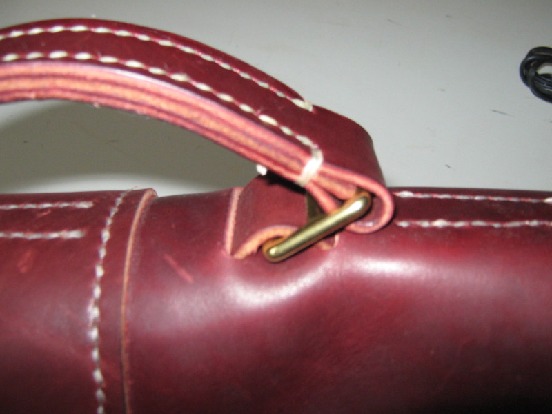

The strap dee rings need to be attached to the flap somehow.
I like to use a billet that is attached under the flap and comes through oblong holes in the flap. See photo.
I have found that the stress on the billet is not perpendicular to the stitch line but more parallel to it this way.
Yes the latch is also under stress when the weight of the bag is transferred to the strap and flap.
Most of the bags I have made were for carrying heavy loads (text books,tools,instruments) and the latch I have used mostly were DOT common sense connectors. The connectors don't fail but the connection between the bag and the connector can be overly stressed.
This is one of the reasons I started using horse collar latches.See photo.
I imagine this kind of a latch would not suit your design though.
Anyway one way to reduce the stress on the latch is to move the dee rings to the rear of the bag so the force is shifted to the back of the bag and not the front of the flap so much.See photo.
I also realize that all of these suggestions can compromise your design and vision for this bag.
Your post caught my attention when you used the term "engineering a Top-Strap Bag".I have always approached my work this way.
I wish you luck and success.
