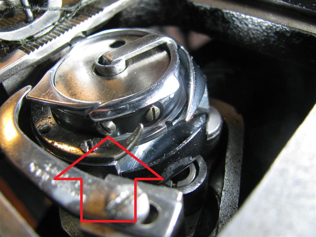

Hi I'm trying to get my machine performing a perfect stitch, but I believe I might have a tension problem. I keep getting little knots in my top stitch where the needle pierces the leather. Can someone help?
thanks, I'm still trying to fix this issue. On the bobbin housing there is three screws could you tell me which screw is for the bobbin tension? Or all three for the tension?
The tension spring on the bobbin case is held by 2 screws - the left one if for tension.
post-31854-0-42137500-1436790585_thumb.j
