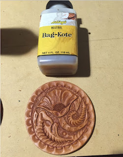

Fiebings Bag Kote
This is my personal favorite. I like how it brings out the tooling and it's not too brown. This is a sealer as well so its a simple solution for me. This is a water base finish. You can buff this out to a shine but like it it nice and flat. This was designed to be used on mail bags, hence the name.

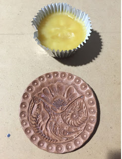

Neatsfoot oil and Bee's Wax
This is an old saddler's method to treat leather. You do a 50/50 mix of Neatsfoot oil and bee's wax. I used a mason jar. I put in my wax and oil in the jar and dropped the jar into boiling water. It will melt together and then you pour it into a cup. I liked the idea of using the the old method and the look is pretty authentic as well.

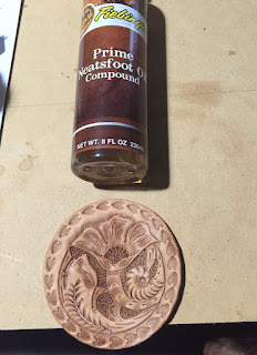

Neatsfoot Oil
This is just Neatsfoot rubbed into the leather. It will darken it up just a little. This is not a sealer but this is how it looks on leather.

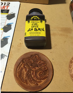

Fiebings Oil Dye - Light Brown
At least I ordered light brown. It didn't say it on the label. This looks more like a dark brown to me. While it's too dark for most of what I have been doing I have used it on trim and it looks good. It's oil dye so it's not going to ever wash out. You can also cut this dye with denatured alcohol to lighten it up. I'm sure this color will come in handy for many things.
