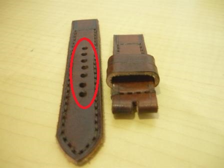

motomuzieq Report post Posted August 12, 2015 Good day everyone... I've been trying to make a watch strap around 2 months and I have issues in making buckle holes... It is very difficult to make buckle holes perfectly aligned...or is it just me? Is there any suggestion? Thank you for all of your help.... Quote Share this post Link to post Share on other sites
electrathon Report post Posted August 12, 2015 Make a templet, keep trying till you get one right. Make it from leather. Clamp it on top of your strap. Punch through your templet into your strap. Perfect every time. Quote Share this post Link to post Share on other sites
motomuzieq Report post Posted August 12, 2015 Make a templet, keep trying till you get one right. Make it from leather. Clamp it on top of your strap. Punch through your templet into your strap. Perfect every time. Leather template... Never crossed in my mind.... Thanks a lot, I'll give it a try Quote Share this post Link to post Share on other sites

SmokeyPoint Report post Posted September 18, 2015 If you're not using a computer, the trick to a template is to make two holes, perfectly centered, perfectly the distance apart you want on a piece of leather as wide as the strap end you will be making. Once you have a template with two perfect holes, make a template of the strap end with one perfectly centered hole (use the first template) the exact distance you want it from the end. Then use a rivet, chicago screw, etc to pin your two-hole template to the top of the strap end template. Mark the second hole, remove template, punch hole, move top template to the hole you just punched, and repeat until you have the strap end template you want. When I am making templates, before I make the final punch on any given hole, I pull out the scale and check center and distance. Measure twice, punch once. As DR80 said, only use the template to mark the holes. I walked in on my wife punching holes THROUGH my template once. Once. Quote Share this post Link to post Share on other sites
electrathon Report post Posted September 19, 2015 If you use leather for your template the leather will easily stretch to allow you to punch through the template. Once your template is straight there is no variance in your hole alignment. Quote Share this post Link to post Share on other sites
motomuzieq Report post Posted September 25, 2015 If you use leather for your template the leather will easily stretch to allow you to punch through the template. Once your template is straight there is no variance in your hole alignment. Electrathon, I wonder... If you made a template from leather, do you harden it? I'm thinking to dip my leather template to boiled water after I finished it, hoping that it would stiffen, so it would be easier to punch a hole from it Quote Share this post Link to post Share on other sites
electrathon Report post Posted September 25, 2015 Do not try to harden it. Just use veg tan. You want the holes to stretch out a little as you are drive the punch through. Quote Share this post Link to post Share on other sites
motomuzieq Report post Posted September 25, 2015 Alright, i'll do that... Thanks a lot, I'll posted the results when it's done Quote Share this post Link to post Share on other sites
