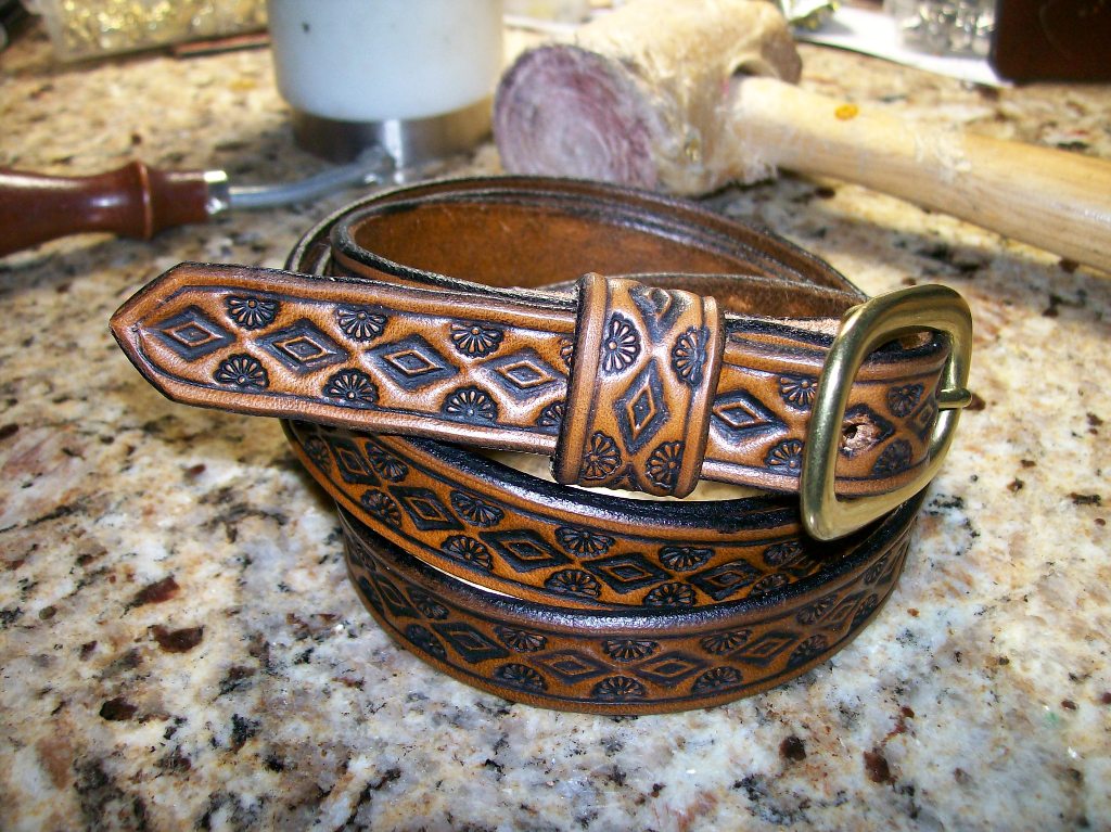

I'm attaching a photo or 2 of a couple of examples of the Antique finish versions.

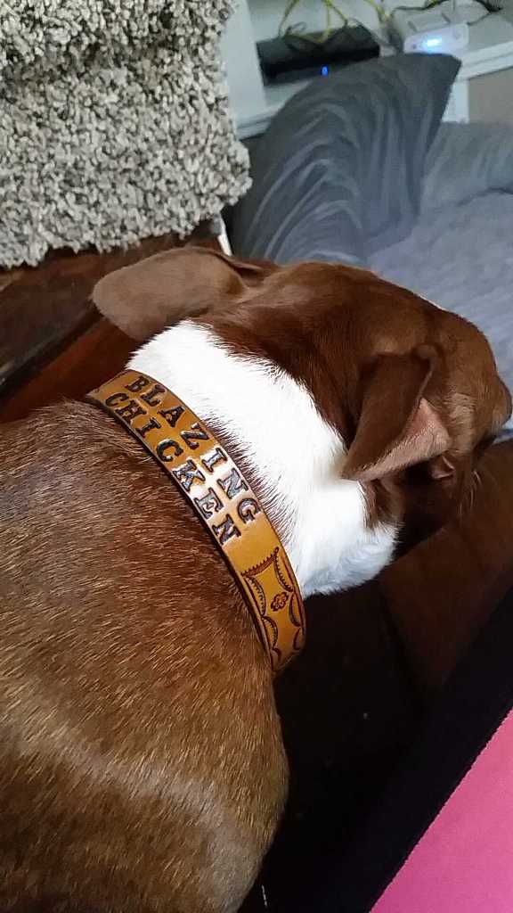

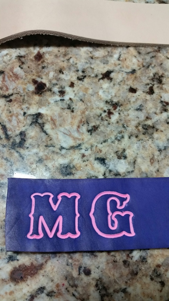

Here are a few that I've used the Molotow paint pens on for highlighting. If the letters are colored, then that is probably acrylic paint on top.
Note: The "Chicken" collar is done with a black regular Sharpie.
