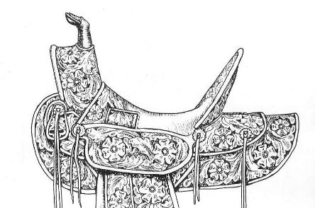

JAM Posted December 5, 2008 Report Posted December 5, 2008 Hi, all, I'm about to try building an old-timey all-day vaquero-style saddle similar to this one (drawn by Ernie Morris in his book El Vaquero - pg 23). Like most saddles in those days (I think), it has a centerfire rig. This saddle won't do any roping, just training, general riding and some trail riding. The cinch will be a mane-hair cinch which will stay where I put it, around the horse's middle. My question is: What disadvantages can you see to using the centerfire rig? Thanks, Julia Quote

JAM Posted December 6, 2008 Author Report Posted December 6, 2008 Wow, I'm glad I asked! All good advice. Cool saddle, Steve - that's what I'm aiming for. That looks like a flat-plate rig, correct? ] And for my broad-backed, big-barreled horse, I guess I'd be wise to stick with a 7/8 or full double rig, since I know that works on her (and most horses). Quote
Members grumpyguy Posted December 6, 2008 Members Report Posted December 6, 2008 (edited) JAM, Who did the drawing on your post? Looks real good! A saddle made from a Visalia 3B or maybe even a Weatherly tree would be real nice. I don't have anything to really add. Bruce is right by what he told you, the centerfire saddle rig has a reputation for not keeping the saddle in place very well. If you'e ever ridden one I think you would be disapointed. Some guys swear by them but I tend to believe it to be a "romanicized notion." I bought one at a yard sale once and slapped it on my horse after testing the fit. (The saddle was older, seen abuse and very narrow but it fit my horse very well who had high and narrow withers. The seat was about fourteen inches in length, too short for me.) That ride wore me out trying to stay on the dang horse. At the end I felt like I'd been beat up. (The movement of the saddle was much rougher than a full rigged roping saddle on the same horse.) I used a standard mohair cincha, breast collar but no crupper, the saddle slid forward when riding down hill and then back into place when going up hill. I had no real problem with side to side due to the good fit on the withers. I could only imagine what it would have been like on a round barreled quarter horse with low, rounder withers such is common today. I never used it again as it turned out to be very uncomfortable for me. Soon after I got rid of the saddle. Now that being said, the Old Califino (By that I mean prior to California becoming a United States possesion.) way was with the single cinch and in what we'd call a three quarter or five eighths rig. Some were also Centerfire rigs. Those fellas were real horsmen as they did not have cars and worked on horse back everyday. They developed a finely tuned balance and the muscles to do it all day. They covered the Southern California coastlands which are steep and are deeply carved with creekbeds, not to mention heavy thickets of brush, searching for cattle. So I'll concede they were much better horsemen than most of us! Well maybe just better than me, I really can't say about everyone else. Edited December 6, 2008 by grumpyguy Quote

JAM Posted December 22, 2008 Author Report Posted December 22, 2008 (edited) Grumpyguy, the drawing is by Ernie Morris in his not-inexpensive book El Vaquero (http://www.elvaquero.com). He is an old Californio and a long-time artist and writer about the old ways. TrooperChuck and HorsehairBraider, I've often wanted to try a thin pad in place of the SMX AirRide pads I've always used, especially since both my mares have saddles that are built on trees made for them. But the blankets I have are too big, and I don't know if I'm supposed to fold them in half or just find a better blanket. This saddle is a 3B (being built as I write by Rod Nikkel) with a 4" cantle and a tall, narrow metal post. It will be fun to build and see how rideable I can make that seat! I'll post pics and a report when it's finished. Julia Edited December 22, 2008 by JAM Quote
