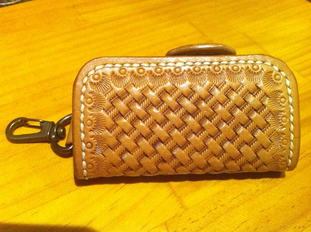

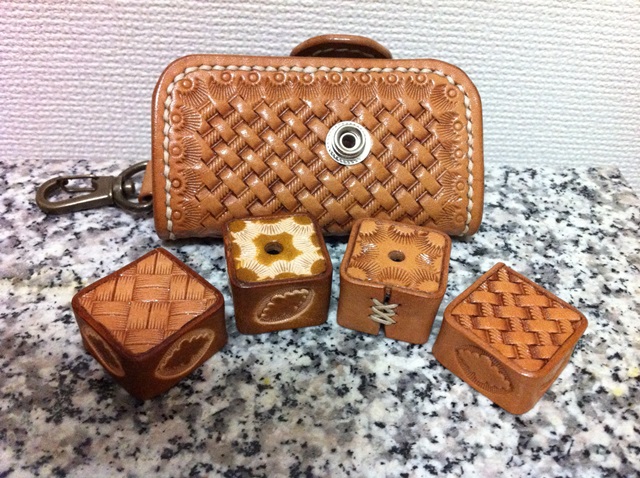

Hi everyone, I see a lot of threads with people struggling to highlight their tooling with antique dyes, so I thought I'd share a technique I've been using that is easy and foolproof. I'm sure it's nothing new or anything, but maybe it can be of some help to someone.
Basically what I do is use neatsfoot oil the same way as a highlighter, applying it liberally and evenly over the entire piece. The key is to quickly wipe the excess oil off the surface with a cloth or paper towel, which will make the surface lighter than the highlighted areas when it dries.
Pros:
Fast, easy and foolproof
Gives a clean, natural-looking highlight
No messy antiques or resists needed
Cons:
Doesn't give as much contrast as proper antique dyes
Too much oiling can lead to oversaturation, especially with thinner leather.
post-65307-0-24777200-1449102779_thumb.j
post-65307-0-63479500-1449102780_thumb.j
Edited by victorl
Just wanted to add a couple things:
-You need to work fairly quickly to wipe the excess oil off before it has a chance to fully soak into the surface
-Like with antiques, make sure that the oil gets into all the crevices so everything is properly highlighted
If you find places where the tooling isn't well-highlighted, you can quickly oil and wipe to highlight it.
-After it dries, you can go over the piece again to get a darker look and better highlighting. (Sunlight has a similar effect as well)
