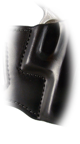

Lines lookin' straight, and the stitchin' looks good. I even like the inlay, though ostrich aint m' favrite ;) Not sure why, but your stitch line looks quite a ways from the trigger guard. Did you have some stretch in there? Your leather should form a bit of a corner under the turns, a bit like this..
post-13153-0-34681000-1452735995_thumb.j
If it doesn't, it's likely due to leather stretch, or stitching too far outside one or more lines, or using leather notably thinner than suggested.

I moved the stich lines over a bit because i never could get the 6" printout on my printer so being on the safe side for fit i moved them over. This was my first holster like this so it was more of a test for several things. And yes the leather was a little lighter than you suggest but was all I had . But I'm learning....
