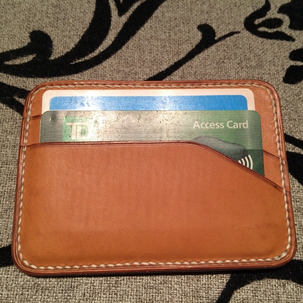

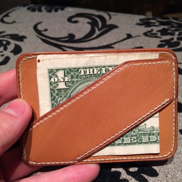

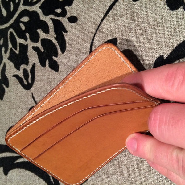

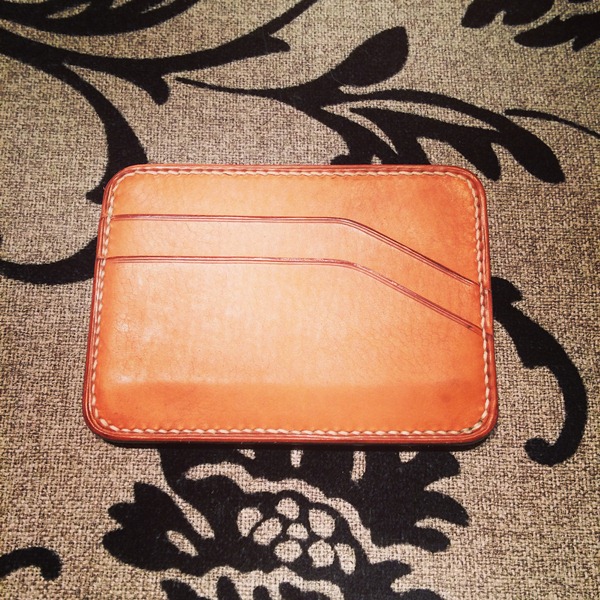

I have been able to accomplish a decent burnish on goat...

This is a firm veg goat leather, lined with veg pigskin on the inside.
When I burnish thin leather like this, I press it down on a flat surface and rub the edge with a cloth. Flip it over and repeat. I also place the piece down on the edge of a flat surface and rub against that (on the side). Get your moisture right, and you should be fine.
The goat used in the wallet above is pretty firm so I had an easier time. A lot of goat skin out there is pretty soft so it's more challenging to burnish, but I think it can be done. I imagine the same for sheep. I have some veg sheep at home which I will try to use for wallet interiors also, so we'll see.
