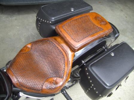

Well, I got the seats done. Not sure if I will tackle the bags or the tank bib next. We'll see. It was a learning experince, but I fairly happy with the way it came out.
AzRider

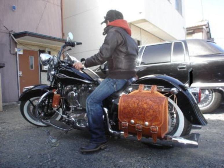

Take a look at these saddle bags. They are on my list of bags to make for my cruizer. The are covered in "Sheridan" design. Good luck and welcome to the forum. By the way, I like the seats...nice BW.
Greetings from Round Rock, Texas
