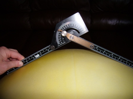

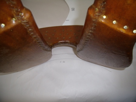

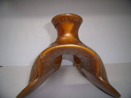

Members CW56 Posted March 7, 2009 Members Report Posted March 7, 2009 Hello everyone! I've only just recently joined the forum but I'm amazed at all of the wonderful information on it! I've spent countless hours going through the saddle making and tree fitting postings and what I've always hoped to come across is a series of photos (instead of drawings or diagrams) showing different styles of bare trees sitting on different types of horses that would show the differnece between an acceptable fit and an unexcepable fit. Has anybody out there ever come across that sort of thing? I'd like to build a saddle or two and even though I have no thoughts of trying to make a living from it I want to understand as much about trees and proper fit as I can. I'm so thankful for this forum! And any help I can get! CW Quote
