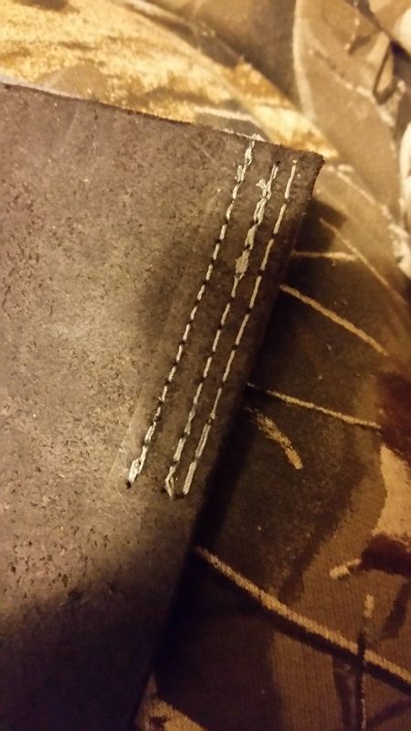

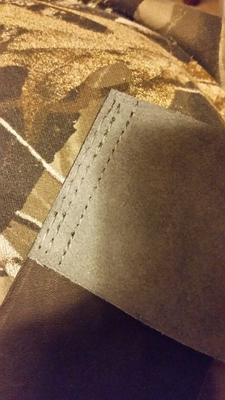

This is the very first piece of material the machine has ever seen.  I set the stitch length to near maximum for the first pass, then reduced it a little, then reduced it a little more.  The second stitch was started forward, reversed to back stitch, then ran forward to complete the seam and that's why it's 3 threads thick.  Everything is hitting the same holes, and I'm delighted.  The only other adjustment I've made was to reduce the top thread tension since it seemed excessive when I was threading it.
#22 needle (yes, it's a little big but the smallest I currently have) with 69 thread.  I melted my tails with a lighter.
Top:
Bottom:

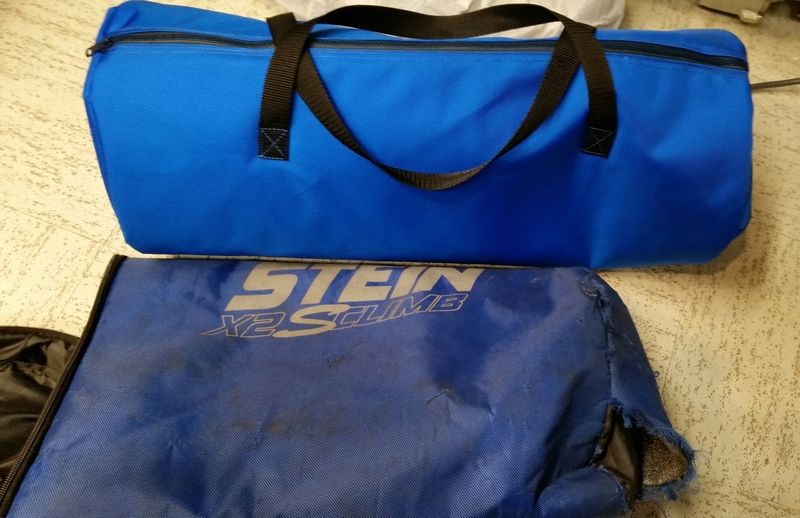

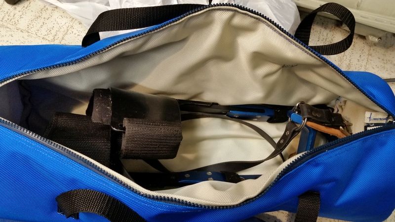

It's not leather, but it was (partially) sewn on the Keestar none the less.
I did the zipper and the four zipper hems on my 211G, but the ends and the straps were done on the 441.  I can't imagine how much hair pulling would've happened had I not been able to use the cylinder arm on the bag ends, and I don't have that much hair left!  :D
There's 1/2" foam between the shell and the liner.

Whats the material you put together there, looks pretty heavy both layers on the weave anyhow.

It's some kind of nylon weave.  The blue stuff has a heavy clear urethane coating and is thicker feeling than the (known) 500D stuff I got that has an opaque urethane layer stuck to the back (different vendor, and not used on this bag).  The off-white is a little lighter than the blue but not by much, and only has a slightly evident coating on it's back side (you can feel it, but seeing it is difficult), which isn't as thick/heavy as the blue.   I didn't really need this to be water repellent, but it's not a bad thing either.  I mainly chose the colors because I like that bright blue, and the off-white is light enough to easily see things in, but not stark white to show dirt.
