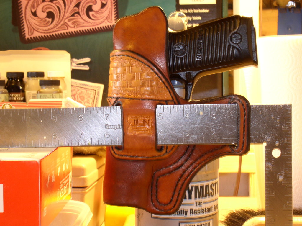

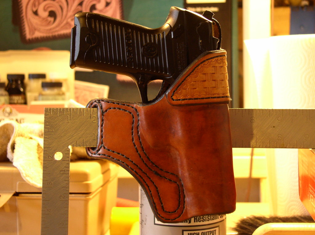

Contributing Member rdb Posted February 5, 2008 Contributing Member Report Posted February 5, 2008 Take the stitches out then run a double row of stitching along side the other row.Should be able to make it look like you planned it, like Randy said.. Then you could give it to me...double lol... Quote Web page Facebook
Members Warren Posted February 5, 2008 Members Report Posted February 5, 2008 Jordan, very nice design as usual! I'm always impressed by how much thought you put into your holsters. I agree with Randy about the stitching. Just dye it black and no one but you will know. Keep up the good work! Warren Quote
Contributing Member Jordan Posted February 5, 2008 Author Contributing Member Report Posted February 5, 2008 Thanks guys, I just couldn't leave it alone. Tommorow I will pull the stitches and try again I think 2 rows will work, I was contemplating lacing but as it is a practice piece that would take along time and I have the leather cut for the Ruger so as my nana used to say idle hands make idle minds. Quote
Members BOOMSTICKHolsters Posted February 5, 2008 Members Report Posted February 5, 2008 I like it. Nice color and a good design. I use two stitch rows pretty often, and I think it makes holsters look more aesthetically pleasing....(wow, that was a big word...my brain hurts now)... I think that you will manage to have a pretty good holster come out of this, and you will learn a lot from it to boot. What machine do you use? Mine is on a servo motor that runs so slow I don't easily make mistakes like that, not that I haven't anyway. I look forward to the Ruger holster. Have you heard about their spiffy new .380 they will release soon? One more gun mold to track down. Quote
Contributing Member Jordan Posted February 5, 2008 Author Contributing Member Report Posted February 5, 2008 I bought Ed's Neels Model 5 awhile back, got it up and running about a week ago. I have'nt used a sewing machine since I was a teenager so that would put it in the realm of ancient history, the key I think is practice adjust, practice adjust and then more practice. Hope is by spring I will have some items I will be able to sell and feel good about the quality and workmanship. One thing I need is some thicker thread, as I think a more pronounced stitch looks alot better. Quote
Members BOOMSTICKHolsters Posted February 5, 2008 Members Report Posted February 5, 2008 I actually considered a Neel's Saddlery machine when I was looking, but I went with the Artisan Toro 3000. What weight thread are you using? I like 277 top and bottom, personally. Thee are some makers who even use 346 for top or both, but I don't feel that is necessary. Quote
Members K-Man Posted February 5, 2008 Members Report Posted February 5, 2008 Nice job on the holsters, Jordan. Neel's Saddlery Model 5 machine is an excellent machine, as I had one for about 2 years. I made a number of products with it, some of which have appeared on the cover of magazines. And in one instance, we made some items for a young girl who ended up winning first place in the costume contest at the Star Wars convention in Indianapolis a couple of years ago. I use 346 thread on the top and 277 thread on the bottom for the style of holster that you have pictured. Quote
Contributing Member Jordan Posted February 5, 2008 Author Contributing Member Report Posted February 5, 2008 I have'nt a clue as to thread size, no label on it. Ed sent it along with the machine. There is a shop close by that I may visit today, they are a service center for most non-commercial machines but are well stocked with fabric threads and all that sewing type stuff, maybe they will have something if not I'm sure thet can order me some. Quote
Members K-Man Posted February 5, 2008 Members Report Posted February 5, 2008 If they don't have it, or it seems like a big struggle for them to get it, let me know. I have 1 lb spools of both black and white natural in the 346, 277, 207, and 138 size that I could sell you. A 1 lb spool will last you a good long while. Quote
Contributing Member Regis Posted February 5, 2008 Contributing Member Report Posted February 5, 2008 Jordan, Be sure to match needle size with thread size. I think there are a number of posts about that here in the forum. A store for non-industrial may not have anything useful for leatherwork larger than garmet. Quote God, Family, and Country (although liberals are attempting to destroy these in the USA)
