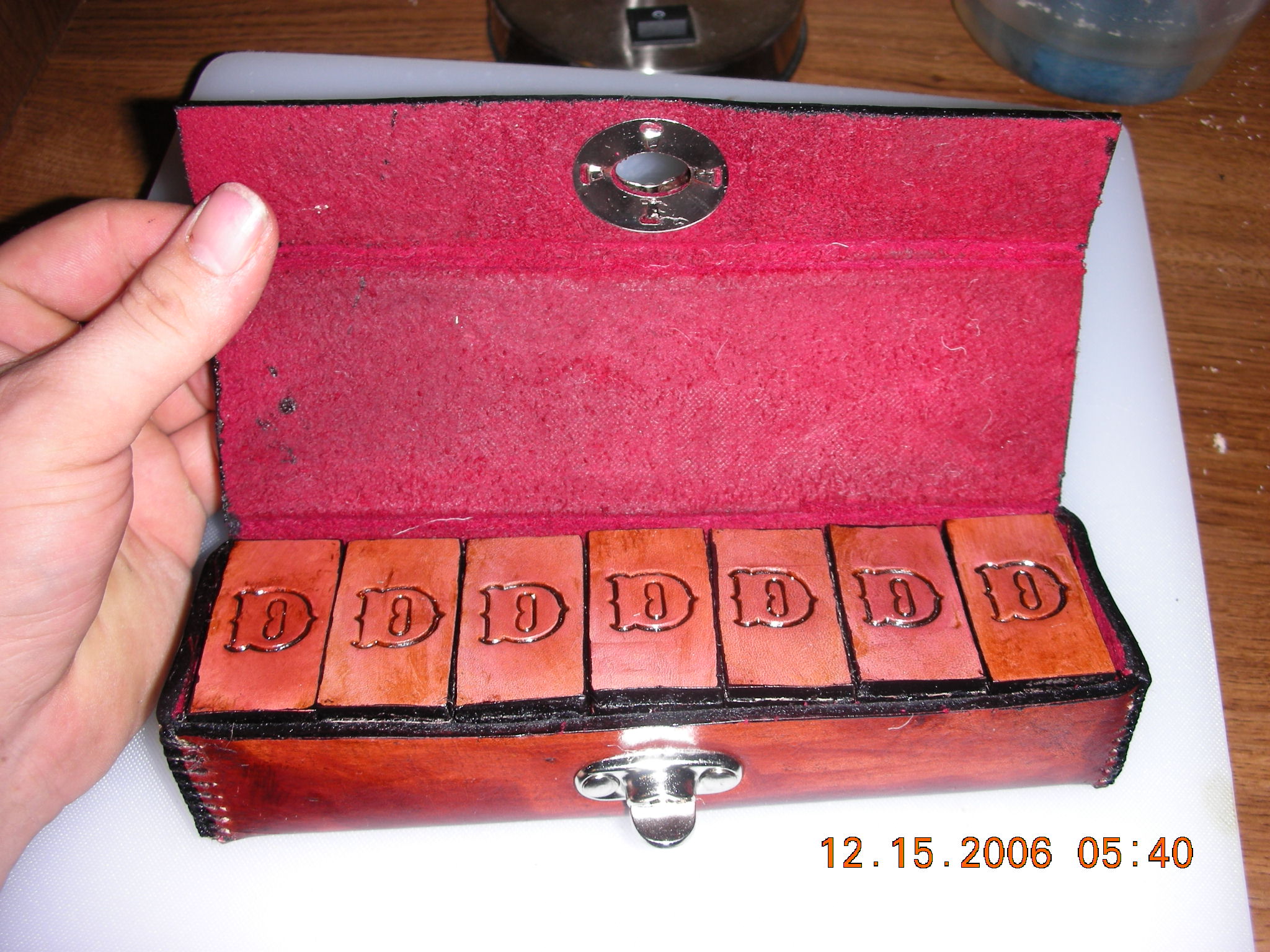

Contributing Member wolvenstien Posted August 3, 2007 Contributing Member Report Posted August 3, 2007 First off.... if you are going to boards and posting and getting flamed.... screw em.... It is totally up to you as the artist. It is your creation and you do it as you see fit.... The customers who buy your products and pay your bills do not complain.... you are doing it right.... I am like whinewine, it depends on the item I am making.... some items get dyed and finished as I am making it, others get done once it is put together.... a picture gets nothing on the backside.... a knife sheath gets nothing inside it, or in the belt loop.... but a box, or whatever would... just depends on the item and the application.... Attached is a pic of a box I made to hold a set of dominos I made last Christmas for a friend... I dyed and oiled it inside and out.... now when i do a collar for a pet, i do not do the inside, but if it is for a human... I do... just depends... Quote "The miracle is not how two adults can create a child, the phenomenon is how quickly a child can create two adults." -- VYBE Her: Hit Me Him: Do you want me to use the knife? Her: No, When you hit with a knife, that's STABBING!
