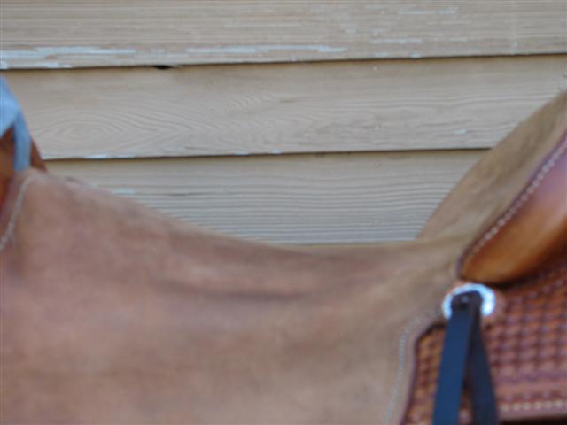

Rod and Denise Nikkel Posted August 11, 2007 Report Posted August 11, 2007 Seeing KAWs saddle with that tall cantle set me to wondering again... We have built cantles from as low as 2 3/4" (a copy tree from an old, broken saddle) to 6" tall. Some makers have expressed concerns with tall cantles catching a rider in the back if things "get western". Other don't think it is a problem. While cantle height is often rider preference, height combined with angle and dish also affect how the groundseat is built. Questions for the saddle makers: What cantle height do you prefer and why? How does it affect your groundseat? Do you have safety concerns with taller cantles? Are there any cantle heights you would refuse to build on and why? Quote "Every tree maker does things differently." www.rodnikkel.com
Members Alan Bell Posted August 12, 2007 Members Report Posted August 12, 2007 Rod and Denise, I was going to try and talk to you about this very thing. I printed out your articles about cantles, horns, gullet width, etc. It got me to really thinking about the "forward seat" and its mysteries! part of the function of the slick fork was to be able to allow a rider to sit a bit more forward comfortably thus enabling you to be a bit more in line with the horses balance spot. Of course this balance spot moves forward the faster the horse goes so with a slick fork you are not fighting to stay 'up' with the horse. Theoretically! As you said the height and angle affect the ground seat as does the number of layers to the build up in a ground seat AND where the strainer attaches to the fork. Might then an shallow angle on the inside of the cantle help slide the rider into the sweet spot and tuck the hips which rounds the lower back placing the rider on his "W's"? So then with a shallower angle or dish how does this affect the cantle height? Wouldn't we want a straighter cantle back because a leaning one with a shallow dish would be basically tipping the cantle backwards? Is that a factor? The saddle tree maker fits the horse: the saddle maker fits the rider. Maybe not totally true! Can't we design a tree that will make it easier for the saddle maker to fit the rider into the position that is most beneficial to balanced/centered riding? My brain is swimming! Vaya Coin Dios, Alan Bell Natty Dread Rides Again! Bob Marley Quote
Members KAW Posted August 13, 2007 Members Report Posted August 13, 2007 I will order whatever the customer wants, they are paying for what they want so that is what they get, I may make suggestions but it is their choice. Quote
