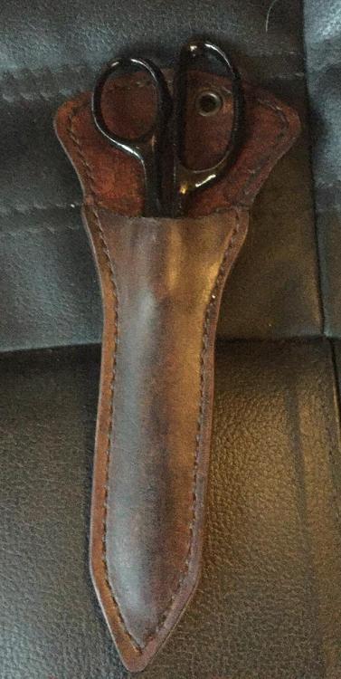

Thank you for the replies. I was thinking of making something like this (except with a bend and/or angled "mouth" in it to match the bend in the shear handles):
and possibly forming it around a 1" or 2" long hollow cone of sheet metal at the bottom (instead of the four rivets) as a stab guard in case I fell down or whatever. So I guess 2mm (5 oz?) veg tan leather would be the way to go...?

I would make it something like the shape I've drawn over your image

Thank you, FredK, that's what I was thinking, too. I guess the seam would need to be on the left in your picture, and the fold on the right, unless there's a way to form a fold with an angular bend in it...(I would prefer to put the fold on the left in your picture, because it seems as though it would be easier to holster/unholster the shears that way, but I don't know whether it's possible to form a bend into a fold...seems like it would cause puckers/wrinkles...)

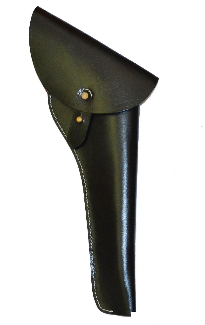

Are you wanting a flap over the finger loops?
Then look to the pattern of a US Civil War style pistol holster for a flap at an angle and adapt

Thanks, FredK. No, I don't want a flap. I want to be able to grab the finger loops readily and quickly with my right hand, and since the handles are bent upwards rather than downwards (like a  pistol), I guess the wider part of the holster would be on the right in your pic, rather than on the left...assuming the holster would be worn on the right hip.
Now that I think about it, it should work fine if the fold is toward the back and the seam is toward the front (with holster worn on right hip) -- I could cut a piece of polyethylene or something, and fit it into the folded (aft) side to reduce wear and allow the shears to be holstered faster. I have a long flexible Forschner fillet knife whose sheath is made this way, and it works fine...
