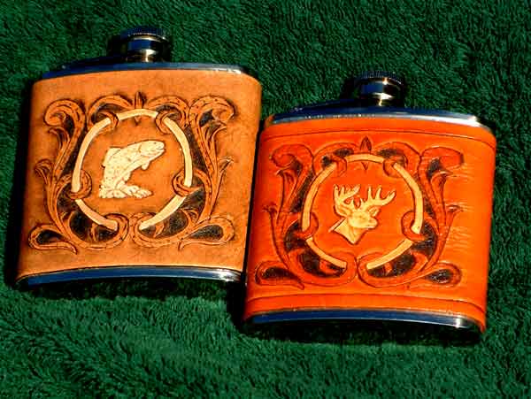

Hi All
I suppose that this is a case of put up or shut up.
I am an absolute novice and over here in North East England I have very little guidance. God bless the Tandy website.
Here are a couple of Tandy kits that I have completed. Comments would be VERY welcome.
The First is a cig case
Second is a couple of Hip Flasks
And third a Ropers wallet
Tear me to Bits

If you're looking for criticism, I don't have much to offer. I think you did a really great job on all of these projects. I've tried my hand at the Tandy kits and can never make them turn out right, so congratulations on your success!
Keep up the good work; it's obvious you have a talent for leathercraft.

When you are lacing, always start (and end) in the most inconspicous place, and never on a place subject to stress. It really helps to double up a few times around the corners for a neater appearance, and bang it flat with the back end of your mallet when you are through, then burnish the edge with a wheel or antler. When you start doing your own patterns, I would suggest punching holes as slits with chisels rather than round holes like kits have. If you are lacing right, the stitch is pulled to the top, and when held up to light, you can't see any holes.
If you're wondering why I have not mentioned carving (which you show an obvious talent for) it's because I am possibly the world's worst carver, and probably always will be.

Many thanks for the constructive critisism. It was very helpful. I am particularly interested in the comments about casing. I use the "dampen wait ten minutes and go" system. I look forward to trying the altenative.
Thanks again
Al
