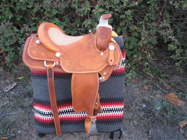

Moderator bruce johnson Posted February 5, 2008 Moderator Report Posted February 5, 2008 JW, After doing my first plate probably 5 years ago, I don't go back except on repairs or for a specific purpose. I like them, and find at least how I was taught to put them in, no significant issues with bulk. I see some guys who have used a deep skirt pattern. They make a relatively shallow plate pattern and the ring is on top of the skirt. That looks bulky, and I am sure is not traditional (i.e. "dropped plate rigging"). A shallower skirt pattern or butterfly pattern skirt, and the rigging dropping below that is less bulky. Using good leather, and longer tapered skives on the liner can help with the bulk issue. I am attaching a pic of my wife's saddle. It has little shallower skirts, and the plate drops off the skirts. I have got on and schooled quite a bit in this saddle, and I really couldn't have told you there was a plate rigging in it. Where I hit with my legs and feet is below the rigging. After you put a few plates in, and then go back and do a dee ring rigging, the dee set up looks pretty anemic. Quote

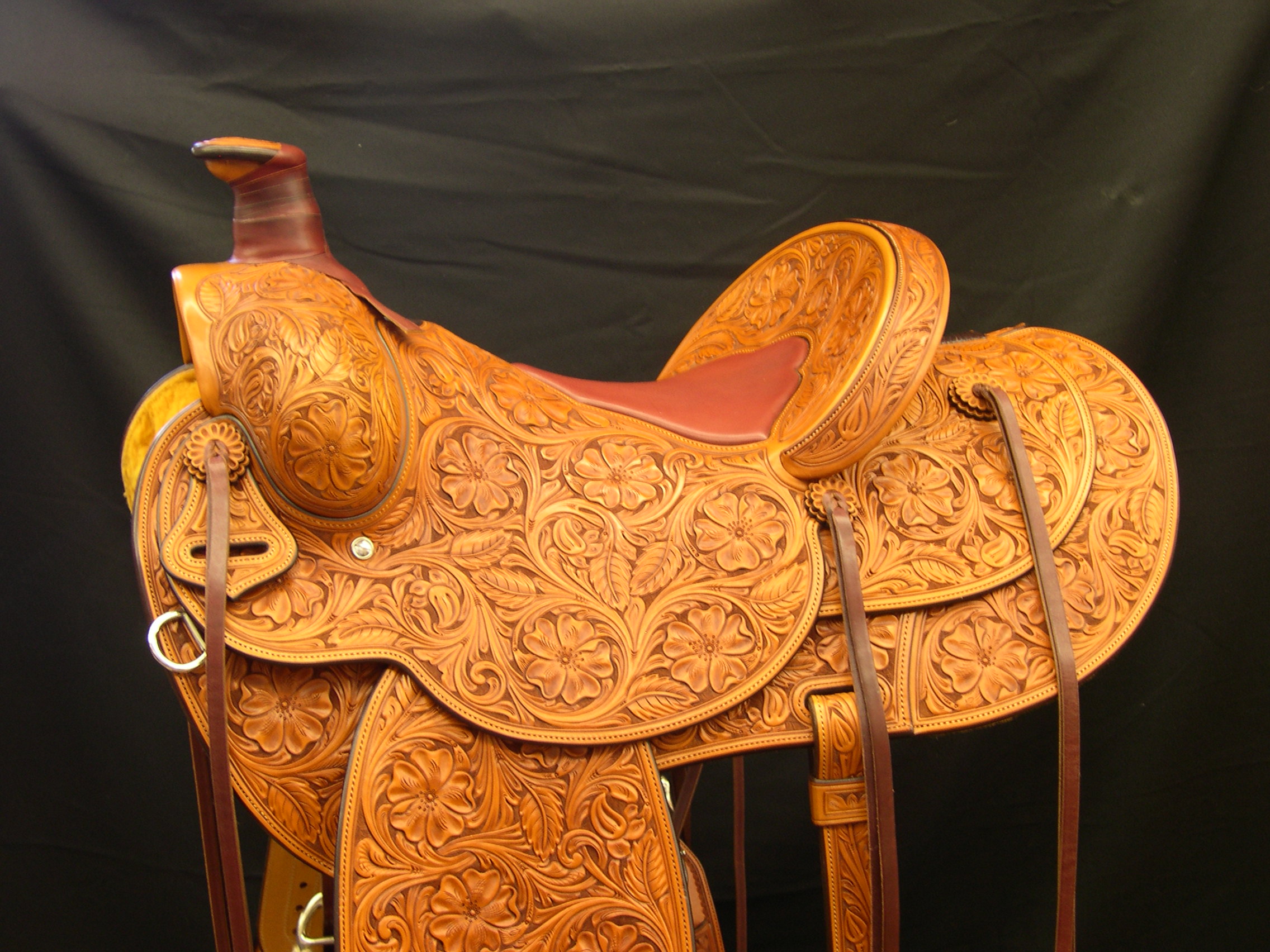

Members jonwatsabaugh Posted February 5, 2008 Members Report Posted February 5, 2008 Good comment about the inskirt Bob. I primarily use flat plate and inskirt rigging. If done properly, inskirts are very rugged, and will allow your fenders forward easily. Always use good leather in your skirt as well as the rigging leather. You will notice the bulk difference and a nice smooth flow from butt to heals. AS far as the flat plate, I use 9/10 Herman Oak For both the front piece and liner. Cut all these pieces out of the butt and you will end up with a very thin but very substantial rigging. I know this requires a lot of leather, but as I always say, "just good enough, just isn't good enough". Here is a pic of an inskirt I recently did. Jon Quote
