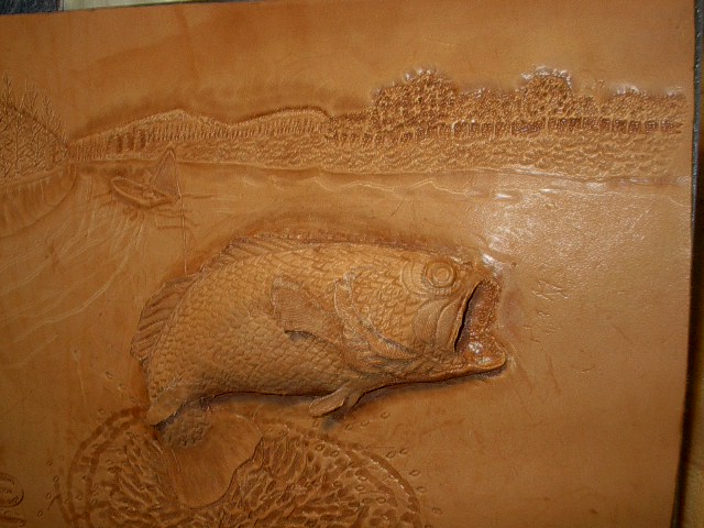

Here are a few pictures of an embossed bass I did and just finished.
Karl

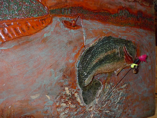

Thanks a lot Greybeard, I think it looks like the ole boy caught the bass just about the time the evening sun is setting and reflecting on the water. Oh, by the way, thats a real fishing lure and lline in the mouth of the bass.
Karl

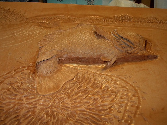

Hennessy, I don't know how wood putty and sawdust woiuld work, I've never tried it or heard of anyone trying to use it either. It has to harden up but has to be plyable enough to do tooling on the fish, deer, horse or whatever you are doing, and also when you cut around parts of the figure and raise it you have to use the leather putty which is the same color and texture as the rest and moldable when you fill in an area and can also add some detail to it with a exacto knife or special stamping tool for feather or scale texture and have it hold the pattern.
The only thing I could say is, what have you got to lose and start out on a small project and not on something large enough that you've ruined a sizable piece of leather, and if it works let us know.
Tihe lighting on the fish photo was lousy and no flash and the picture looks just like the evening sun setting with the dark shades from a somewhat cloudy and stormy type clouds but the color photo didn't turn out that good but the natural colored leather photo's I took of it before painting look fine. Go figure. I guess it is the gloss of the acrylic paints after antiquing the background doesn't show like it does in person. Oh well, It looks great on the wall and the detail in the bass and scales are just right. Karl
