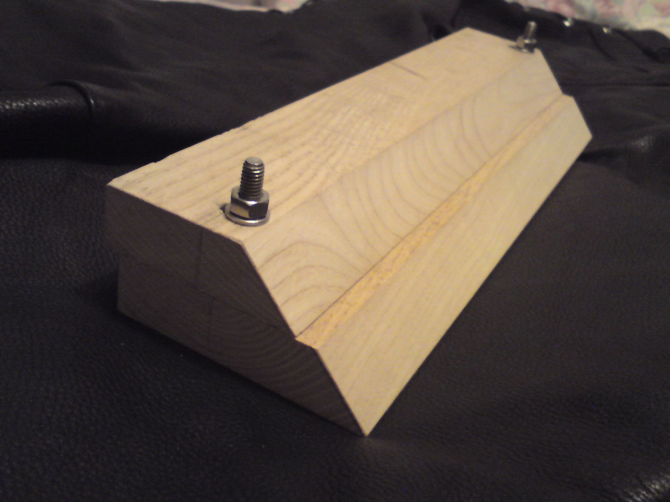

I made a simple sketch and my boss was so kind as to make it for me! See attached picture. I had a few goes with it, but it requires some practice. I might try using a razor instead of the french skive. I posted the picture in another thread but I'll post it here anyway.
It requires slotted holes in the top piece so that leather of different thickness may be cut.

Odin what i was thinking about when i said two pieces at 45 degrees was to have both of the pieces even. The top piece needs to moved over to be even with the bottom piece in your picture. Then you can slide your edger across and cut the angle.
But it the one you have made works you don't need to change. Be sure and post a picture of what your making.

I do move the top part over. There are slots at the top so it can slide to take different thickness's of leather. I use a straight edge to line them up properly. If I get good results Ill post them here.
I see the slots now. The washer had had most of it covered. I should of looked closer.
