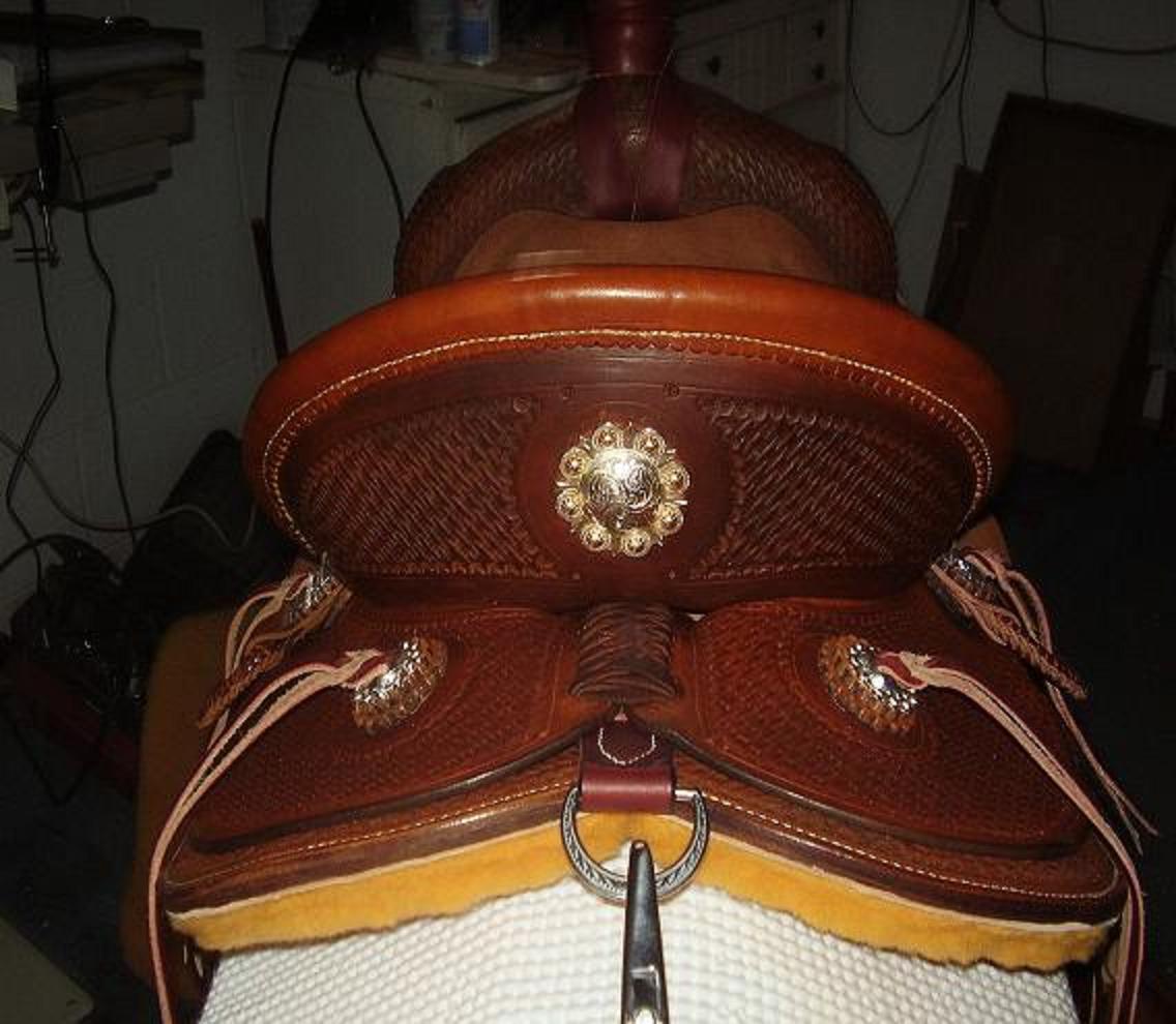

Here is the latest saddle I just made and delivered for one of my customers. It is for a mule as you can see in the pics. Because this mule is quite stout she couldn't find a saddle that fit him , and she is very particular with what she does and rides. She normally likes a some "bling", however; in this case while she wanted it to look good, she also wanted it to look "old timey" . This one is built on a C S Roper style tree with mule bars , a cruper D, external stirrup leathers and a 5" cantle. She wanted the dark oil look. Delivered it today, the smile on here face says it all. Feel free to critique, your comments are welcome.

Thanks for the kind comments from all. Shooter, the answer is that I have my trees made custom for me. When I take an order, I make a template of of the animals' back, and send it to my tree maker with the specifications that the owner wants, such as cantle height, horn type and size, style of tree ect.

Hi Bob!
I really like the look of that saddle! Nice job!
I ve got some "technical" questions for you , though ;)
1st : about the dees: i would not have dared to use so big ones. Are not they a bit too big (not going to rub anything around?)
2d : about the saddle tree : can i ask you which saddle tree maker did it for you? i am looking around for who could build that for me (mules bars) .
3d : what is the placement of the rigging dee? from where i sit it does look like a "full" but maybe it's a trick from the picture?
4th : about the color : how did you get that "dark" aspect? is it only by oiling it? you might have spent some time oiling it ...and you oiled it with what stuff?
5th : i like the conchos screwed on the back cantle but i have not yet dared to do it...kinda afraid of going all the way through the back cantle right in the middle of the seat ;)
Thanks Aurelie! I'll see if I can answer your questions.
1) The D's are large, however; they were what the customer wanted. They seem to work nicely on this saddle and with this mule.
2) This saddle like most of the saddles I build, has a Bowden tree in it. David Bowden makes all my trees himself. The bars are not specifically just "mule" bars. These folks had a really hard time trying to find an off the shelf saddle with , what was advertised as mule bars, to fit this mule. Since I have made several custom saddles for them in the past for horses they had problems fitting they came to me for another one. What I do, and I believe most custom saddlemakers do, is send templates of the animal's back to the tree maker and let him know what it is that they are building. In a lot of cases, they use the Lane system to show the maker what the animal configured like, and let the tree maker make the saddle to fit. Personally I don't use the Lane system. I take 4 templates from front to back, a) at the top of the whithers, B) at the lowest point of the animal's back, c) 6" inches back from that , and d) 6" inches farther back from that. I then make a template of the animal from front to back along the spinal column. I put the cross sections onto it at the respective places they were taken and send that to my maker. I have yet (in the last 15 or so years ) had one that didn't fit perfectly when it came back. I also take a couple of pictures of the animal, both profile and from the rear to show the maker visually what he is dealing with. It must be said, that there are lots of makers out there, Rod and Denise, Jon Whatsabaug, and others that will be able to make you a good fitting tree with those templates. I started out shopping around, many years ago, and eventually settled on Bowden, and for the money, ( a major consideration in the market for which I service) they have not let me down. To give you an idea of what the cost of this saddle was it was $3300. If I used some of the others it would have been $300 to $400 more and would have priced me out of the market.
3) This saddle is actually set between full and 7/8's rigging. When I set the tree in the place where it should be on the mule, this is where the cinch wanted to be. Who am I to argue with a cinch?
4)First, it was stained with Fieblings saddle tan pro oil die. twice. Then once dry, I went back with several coats of pure neatsfoot oil, and finally, worked in a couple coats of saddle soap. Normally I would have also used Tan Coat, but; the customer was addamate that she wanted that dull leather look.
5)In this case, I punched a hole in the back cantle leather, after ci formed it to the cantle, and used it for the center of all the stamping. Then, I put a screw though into the concho, if you do it that way be sure to use a liberal amount of red lock-tite on the threads so that it won't come loose later.
Hope that covers it for you.

Nice job. Did you scallop cut your cantle binding before final fit and sewing, or after you sewed it? Also, what kind of sewing machine do you use, just curious looking at your skirt stitch line. Am also interested in the Dennis Lane system, ordered a set of the cards but haven't used them yet.
Harrington, thanks. Actually I did the final fit and let the binding dry fully. Then I took it off and cut the scallops. Then glued and stitched it back on. I like to let the binding come to a complete dry, so that when I hand stitch the binding I don't pull the stitches though the wet leather when pulling them tight. As for the skirt lines, for years I have used a Boss, however; I finally got a new CB4500 and this is the first one I've done with it, still getting used to the "gas pedal" ! The machine is great, user, not so much!!! Yet! LOL
