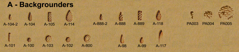

One of the series with background tools (including yours) in different sizes and shapes is:
Going from smallest to the biggest...
A104-2, A104, A105, A114
the next series with a bit bigger pattern than the last is:
A888-2, A888, A889, A118...
Hang on I post a picturechart I've made for them :-) Ther PA tools is from Hidecrafters...

Thanks for posting the picture Tina! I have the A104-2, A104, A114 tools and the PA series. I tried to use the A114 tool on the larger areas but the pattern it leaves is coarser than the A104 so I felt that it didnt look right. I shall try out some practice tooling with all of them again on a scrap.
"but the pattern it leaves is coarser than the A104" ...Could it be that these tools of yours is from different time periods of Crafttools or different makers even?
The one I use the most in big areas is A105. This one is the easiest to get even and at the same time fastest to cover big surfaces...Just tapping along and go over the same/edge areas again (and again *S*)
