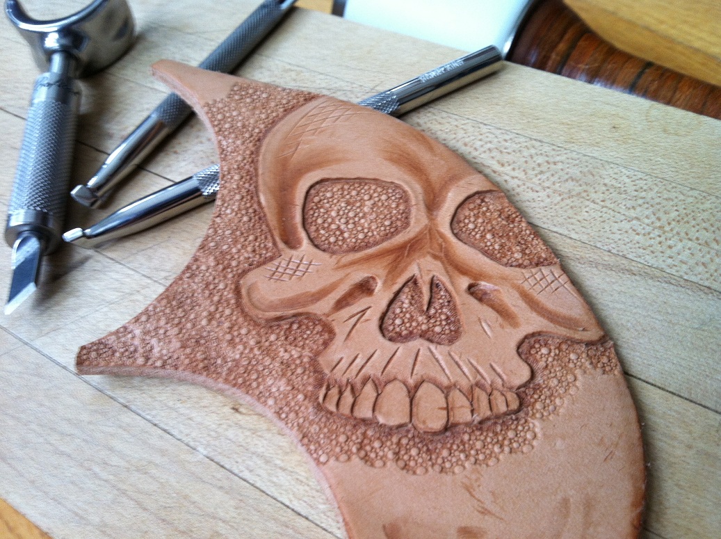

Hi, I just started leather carving/tooling two days ago as soon as my new BK tools arrived in the mail.
The local Tandy shop personal doesnt tool leather so she was unable to answer my questions but recomended some of the Tandy books. My Grandfather was into this craft and left me some vintage late 50's Craftools & old Craftaide patterns for wallets/belts along with a bunch of rivets and snaps. I still need to pick up the rest of my Grandfather's old literature as I feel it's the same vintage as what Tandy offers today. Would prefer some newer Leather Tooling/Carving books if anyone has any good recomendations.
I'm a self taught artist so I decided to just dive into this craft and will be starting with custom work belts & suspenders. I plan to give away my first samples, at least till I improve.
Most of the tooling pictures i've seen here are not close up and I can't tell when the beveler is used when using the backgrounder or matter. So my question is, When using a backgrounder or Matter, Do I bevel my swivel cuts first? Chris
attatched is a picture of a freehand swivel knife cut skull using the new stainless steel Craftool-Pro with 1/4" angle blade on a scrap veg tan 7/8 oz. piece. I used the BK checked #0,#2 beveler then used a HideCrafter pebble matter.

yes, for the most part you'll want to start with the beveler. This puts your background into relief and gives the artwork the 3d appearance.

You definately have the concept of bringing the subject to the foreground. Western carving is a little different, but not much. As far as books go, all the Stohlman stuff will be valid forever, also the other classic artists. Tandy doodle pages are also helpful and available from Tandy, but not free anymore. It is obvious that you have some art background, the piece looks good. I might have used a different background for the eyes and nose, but that is just me.

As far as the background inside the skull. I hear ya, it was all I had to work with till I expand my tool selection. Sad excuse as it makes the piece look flat and 2D. Also not a great angle on that skull.
I'm also gonna take a stab at making my own tools out of SS bolts to get the effect each piece will require as I get more into this artform. Thanks for the kind words on my practice piece. Chris

with a piece like that, I would have left the eyes and nose with no background. Just bevel them down to make the area behind the face look like it's empty. By backgrounding it, you made it look like the front of the skull is sitting there with nothing behind it. It still looks really good, just a bit of advice in thinking about the subject matter and letting it be your guide.

Cyberthrasher, here is a better one to break apart. Started this one today after your last post. It's still a work in progress and I'll have to come back and finish it in a few days as time permits. Again, still using scrap veg tan. Broke out Granpa's Old Craftool smooth bevelers and a few finishing nails for the smaller dots.
Would like to make a larger Pebble stone matter to use in the foreground under the skull to add a 3D effect and really make it pop. Chris

And this is just your second piece????
The only thing I see is that you need a modeling spoon to round off the edges after beveling. But, that's minor when compared to the rest of the work. I love the look of smooth bevelers and how the really make a piece pop and look natural. You're rockin' it man!!
For a pebbler, I know some people grab a bit of wooden dowel and hammer the end into the concrete to make a nice tooling pattern in it. I just bought all 3 sizes of pebblers that are available and decided it works well enough for me.
Oh yeah, and usually you should go through and make all your cuts and then come back to start the tooling. It's not a hard rule, but once you get used to when you might want to hold off I'd get it all done first. Also, very the depths of your cuts to match the piece as it relates to the 3D depth. I think this is the lesson from Paul Burnett that really opened my eyes on thinking about the piece when cutting and tooling.
