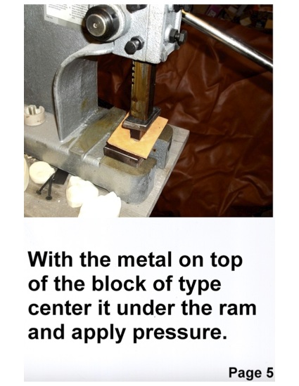

Raymond Tipton sent me this information and thought I'd share...
Raymond sells emboss plates and emboss machines and rolls, etc. on ebay
at duckcreektraders and also has a website BUNKHOUSE TOOLS
post-15330-0-76972800-1370770575_thumb.j post-15330-0-58384400-1370770610_thumb.j post-15330-0-30255400-1370770643_thumb.j post-15330-0-01082200-1370770675_thumb.j post-15330-0-49985600-1370770713_thumb.j post-15330-0-17408900-1370770829_thumb.j
I do hope Raymond's information has been of help :thumbsup:
I know it was for me......

Didn't think of this before, great idea. Coincidentally I've started buying a few letterpress printing blocks for no other reason than that the designs were attractive. I'll definitely give this a go.
Very nice tutorial.
I might suggest using 3M Scotch Magic Tape since it will not leave a residue on the letterpress type.
Here is an alternative way to place/impress letters on leather and even how to make the letters curve:
www.pslac.org/download_area/Typography%20in%20Leather%20Article.pdf
Hope this is helpful.
