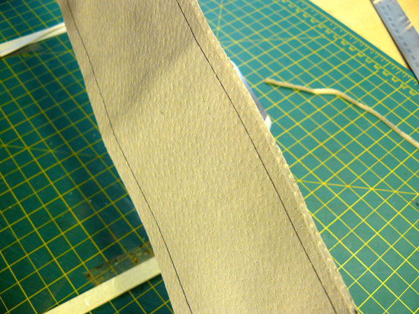

I start with a piece of leather that is to become the pocket of this book cover. I have the outline of the pocket transferred to the flesh side of it, and have already cut along the line of the pocket where it will face in towards the inside of the book. This is the edge to be rolled. The outside edges I leave uncut for now.

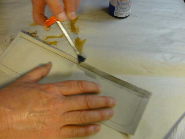

Here, I am applying rubber cement to the fold line to make the fold stick once I fold it. The brush that came with this particular jar of cement is a bit fouled up, so it got a little out of control, but since this surface is not visible, it's not a show-stopper. I do try to avoid that, though, and just put the cement exactly where I need it.
