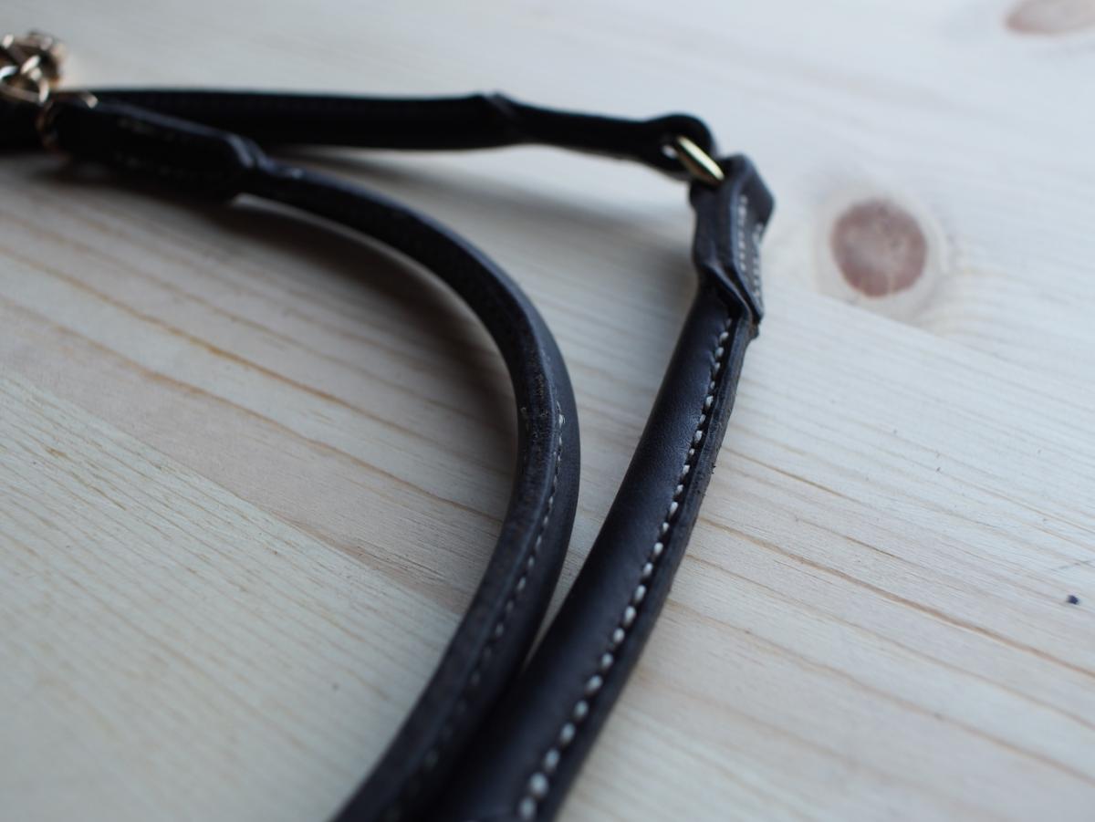

the attached pictures are of a prototype rolled leather leash I made over a year ago. what roo4u listed in their post pretty much summarizes what I did. I used handle #18 & #20 from the Art of Making Leather Cases V2 as a guide to make this. I started with 10-11 oz latigo and split it so that it was thin enough to roll, however the sections attached to the hardware and the handle itself have not been split. There's a core of scrap latigo running down the length of each section, I made a previous prototype w/o the core and it lost the rounded shape over time. without the core the leash would fold over onto itself like a kinked garden hose.
I love the design of this leash and the way it feels in hand. the only problem is that the leash is way too heavy for small dogs, which is who my clients are and my own dogs. Consequently I never bothered to make a matching collar.
I hope the pictures help you out.
Thanks for sharing! It looks really well done :) Beautiful work! ~
