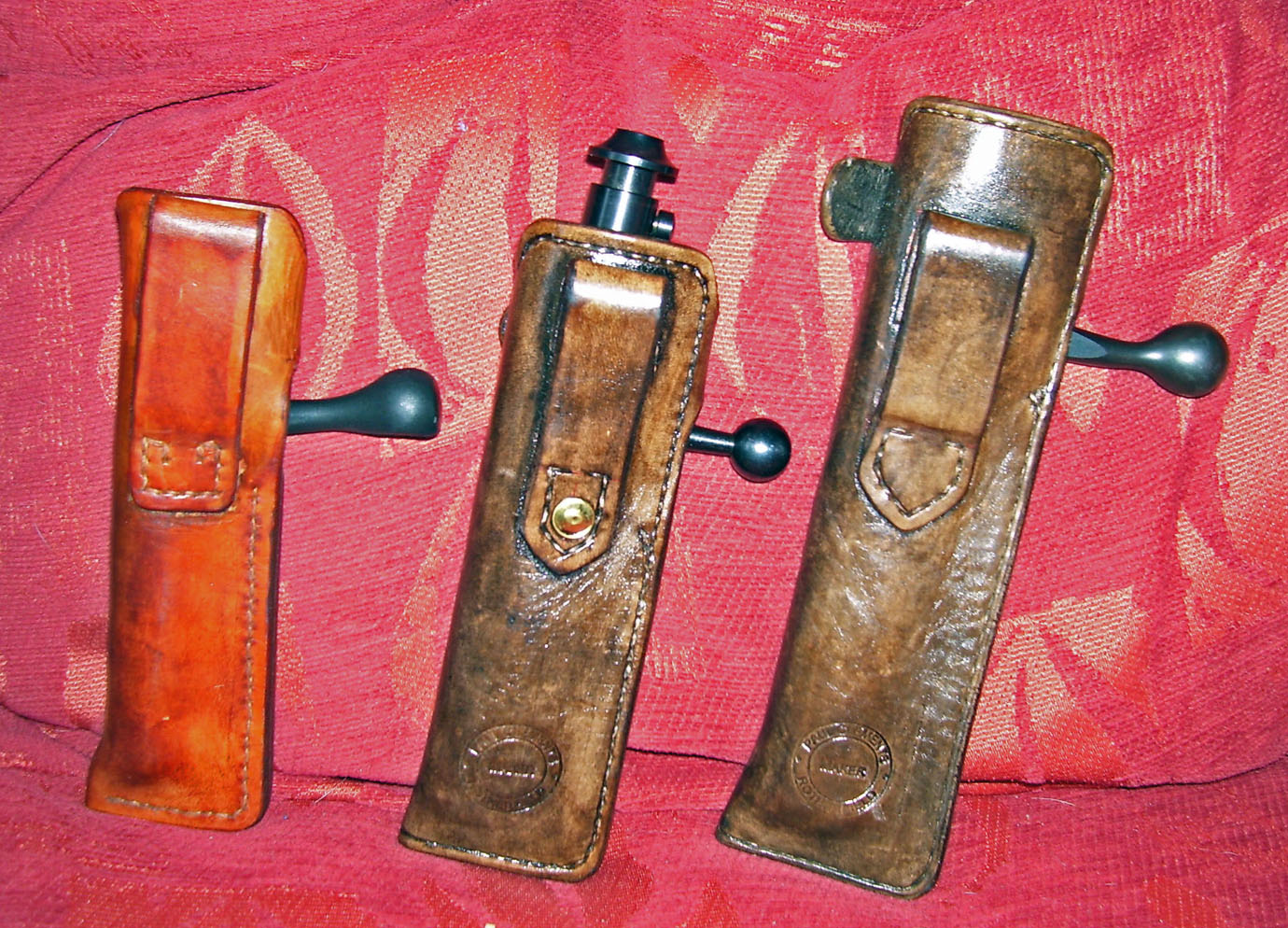

Rant Over !! Now If anybody finds themselves in need of a bolt pouch ,no holster sounds better "Bolt Holster" here`s my basic pattern change do as you will hope its of use BOLT_HOLSTER.pdf Regards Paul BOLT_HOLSTER.pdf -

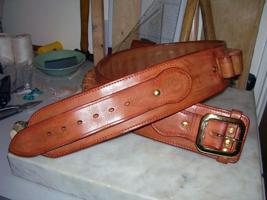

Most mens belt I`ve made are 9/10oz butt veg tan. For a lined gun belt I try to keep the combined leather weight to 12/13oz any heavier and physical weight and comfort start to become a problem.. couple of pic`s shotgun cartridge belt, this is 9oz front and 4oz lining and this is a heavy belt at 13oz leather weightOh! I only glue the edges about 1/2" Hope this helps Paul -

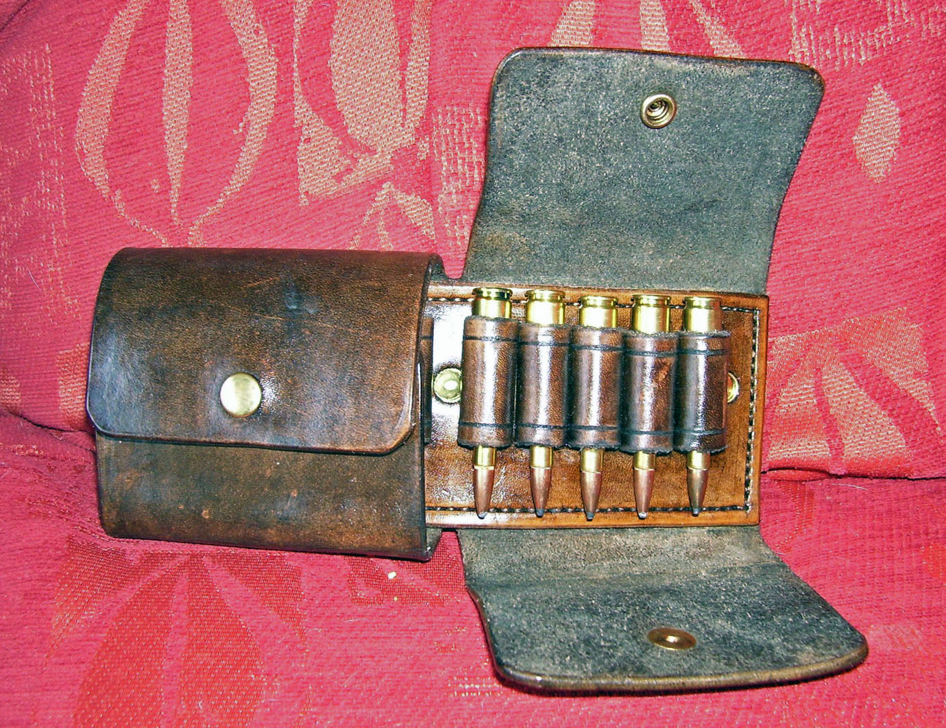

As I said there prototypes the gamekeeper wanted a ten shot and being belt mounted the big long flap didn`t work . I could do a 5 by 5 version AL-la boxes and cases Vol 1 by uncle AL. you know the one that folds down! As for the bolt pouch In Sussex the state I live in you need about 2,000 arces of permissions (written permits to shot on private land) a Lilly white record , not mad ,and no recent separations oh an not terminally ill just to put an application in for a .22 ...... ......Soon you will need a permit to scratch your ..."£$%%^..... Plus there trying to ban knifes I make them too!!! I`am off to sit in a darkened room for a little while.....!""£$%^^^&&&***(()(*&$........ Paul -

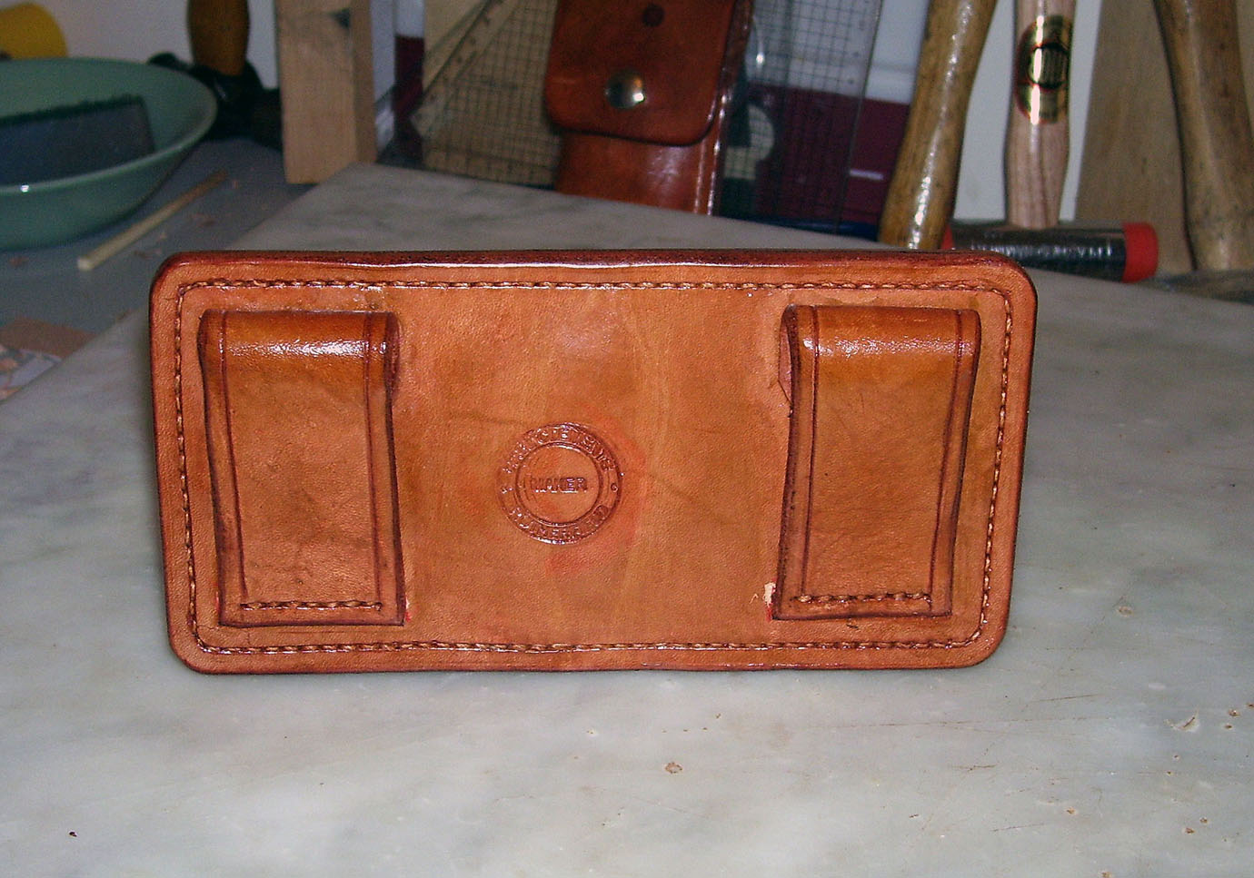

Thank you all for the comments most welcome, now answers to question first off. rdb:on the back of the ammo pouch there`s two 1 1/2" belt loops the flaps are an extension of the back panel same as pic. Next! UKray:Yes I do use veg-tan and dip dye in Tandy ECO-FLO dyes the darker colours have very poor covering ability, thou Canyon Tan I used on the Shotgun Six and six month`s practice comes up much better. I`ve learnt ,if you want a clean consistent tone you have to use the very best quality leather you can getjust look at the loops on the left a heavy grain which showed up after dying!! So I`ll drop you line to take up you offer.. For Now I`ve ordered some Fiebings Oil Based dye`s I`ll give them a go ! Onwards Regis:The second two bolt pouch`s in Bison Brown (dark) are lined two protect the bolt I used 1oz pig skin so far the gun oil has had a negligible effect on the lining`s but time will tell veg tan just drinks it up and you get a bloody mess in no time. As for the Bison Brown it was the first time I used it ,for distressed look ok ! you live and learn and they have held up to daily use quite well.. Thanking You Kindly Paul -
A few pics of what I call prototypes given to gamekeepers.The idea being ,there out in the elements day in day out. I wanted see how my work would fare. These are bolt pouch`s In the UK when you come to anywhere land has public access you must remove your bolt from your rifle, or for that matter the rifle locked in trunk of your car the bolt must be removed and stay with the guns owner so : the bolt pouch.. Ten shot bullet pouch 0.243 : A caliber normally used on Fallow Deer and Roe Deer.. They seemed to have faired well ! what do you think?A smarter version might sell? Regards to All Paul

The pictures are holder and belt for 12 gauge shot gun cartridges for the same client .Holder six shot: the front panel is 9oz backing 6oz loops are 4-5oz and brass rivets every three because the loop is one continuous length any wider spacing causes the loops to slack off when you bend the the belt. belt uses the same weights of leather. the reason for the holder , bigger shot saves hunting around in pockets .In the the belt there`s about three yards of saddle stitching so if you need the practice !! Loop slots cut with 1 1/2 inch oblong every inch. Why so wide? the lad have a bad back. can`t stop a keen sportsman!! Regards Paul
