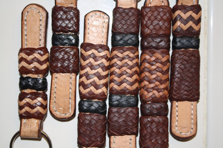

  16. As I mentioned in a previous thread, I purchased a beginner braiding kit to get into using hide instead of paracord. My wife then gave me a complete key fob kit for Christmas. Here are some pictures of the results. My ultimate goal is using rawhide. These are a bit embarassing given the quality of work usually displayed here, but any advice is appreciated!
