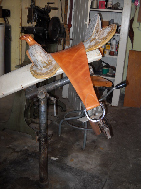

  2. Another picture that might better illustrate the side to side movement you can get.
  3. Tony, The pipe used was 2" ID and 1 1/2 ID. Basically just used windmill pipe. I'm sure if a guy went to a steelyard there would be sizes with closer tolerances to use. I simply welded a 1/4" rod around the ends to keep the sliding pieces from coming off. The first picture might not clearly show that it is tipped at a right angle to the base? You use the drawdown strap to hold the saddle/tree at virtually any position, whether faciing forward or back.
  4. And another from the side with a tree setting backward as if to sew a binding. You can also get an idea how much movement the jack has along the bottom. Sure made it easier sewing a binding on! Get to the side of a cantle, and just roll it over a little more.
  5. A view from the front showing the trailer jack and spreader, while raised.
  6. I made a mention when I first found this site and was amazed at the sharing of info and knowledge, that maybe I could share a little that might help someone. I don't know how much this will help, but it has been a saver for me. IT was a pretty simple concept that hatched in my mind in the mid 80's, and I just started throwing things at it. There are ways to improve it that I've thought of since. Just havn't taken the time, since this one has been working so well for me. It was simple to build, the only cost was the trailer jack which still carries the $22.50 mark on it. the rest was salvaged from the scrap pile behind the shop. If you've got a good shop with better tools, I'm sure you could make one smoother. I was working on a cow outfit, and making my family. Hence, money was tight, and I'm sure a lot of you know the same feeling. I made do with what I had, or built it myself. Most things started as just a thought, and developed into something somewhat usable. My tools at the time were just a hand grinder, cutting torch, and a buzz box. I wasn't too concerned about prettieness, since my work time on this project was pretty limited. So, please forgive the crudeness? I just wanted it servicable. This first picture I hope, shows the workings of this drawdown and maybe gives you and idea of how it functions. Most functions were locked in place by welding a nut with a bolt (swivel handle or T) to a piece of pipe which revolves around a smaller pipe. The (seat) functions both vertically and horizontally. The jack is welded onto a sliding pipe with a strap that goes to the top, that runs along in a track on the upper bottom, to keep it perpendicular to the top. Also note, on the upright pipe there is a locking collar to adjust height, and another locking (for lack of a better term) locking bolt below that, to keep it from swiveling.

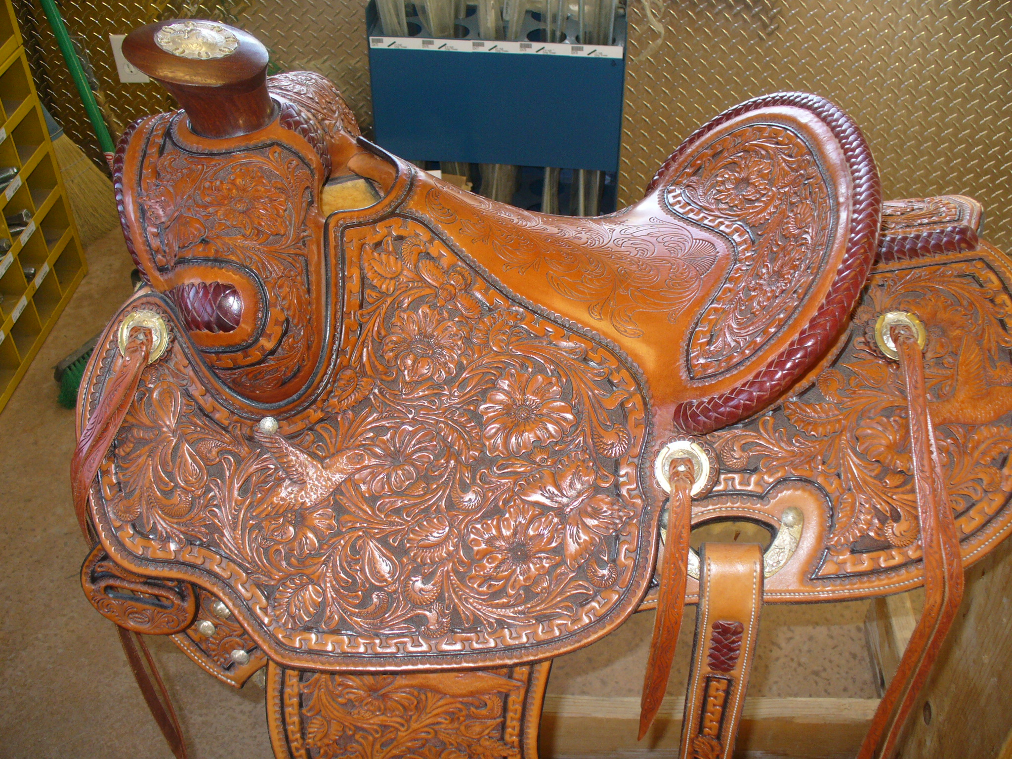

  7. You asked for a critique, I'll try to offer one. The lines and balance on your saddle show lots of good things, as well as the mechanics show from the pictures. I like it and would be glad to throw a leg across it. I'm on dial up and pictures can take forever to download... but on the rear jockeys, I would like to see the area below the top leaf broken up by something and backgrounded. It would be easy to insert a stob or something to break up that area??? Decorative cuts is something I have continually struggled with! On your leaves, I would use more of a lazy S with diminishing cuts below that. Your Deco cuts just need a little more finesse, as mine do! All of my cuts I try to start with a sharp hook, then tapering to a gentle curve and diminishing. It's a challenge, as to where to place them, cuz I don't like to get into shaded areas much. Most of what I've learned was by askiing for a mentor to critique my work... and my work still isn't up to snuff. Don't want anyone to think I'm being critical, just offering a perspective. I'll try to get some stuff up, and you or anyone can critique it. I've always been open to suggestions. There's a couple of saddle pictures posted in a" homemade drawdown stand". I too, liked the graduated circles and placement of them, I hadn't seen that done before! .......Lot's of stuff I havn't seen, and this site is an eye opener for sure! I just keep saying WOW! Maybe we all have had a hard side with cuts?? I don't know, but I still have a harder time with cuts coming from my left, and I say a lot of "well... cheet"... I Don't know if any of us ever reach that pinnacle where we are totally satisfied with our work. Hope I don't. Just living and learning....
  8. Try it this way... a double wammy! Oh yeah! These were built on Rod and Denise Nikkels trees. Nice work you two! The first one was Jarra and the next purple heart if I remember right?
